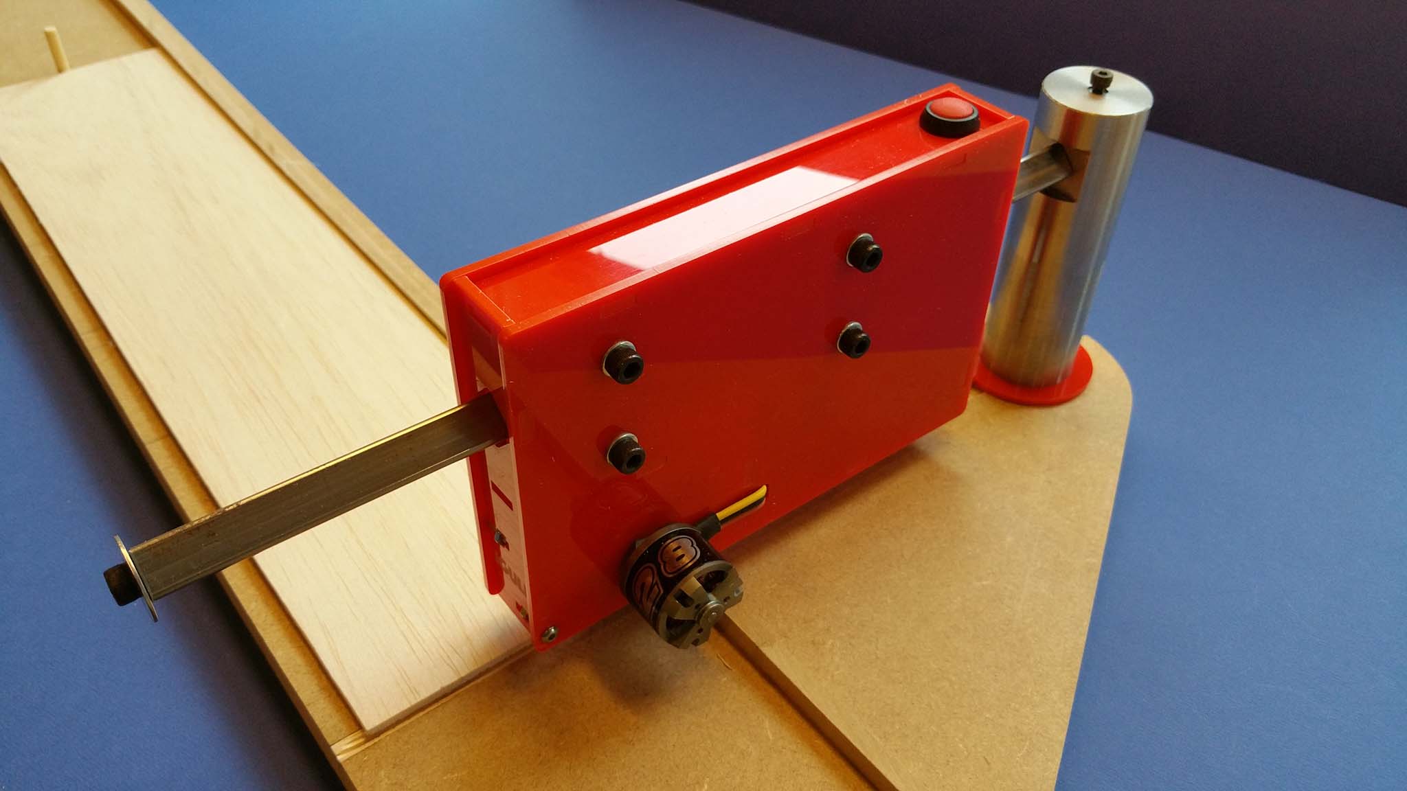

For stripping balsa, it's outstanding - worth finding a wee clamp that'll fit the fence to hold the strip down from the top as it's being cut - easily cut up to 12.7mm - I use the tungsten blade. Definitely worth making a zero clearance insert if you want to cut less than 1mm strip.
Still prefer my old 3 wheel Burgess BK3 bandsaw for cutting ply etc. though.
Have never tried cutting balsa with my festool tracksaw LOL, but I do use this for cross-cutting balsa sheets and short ply sheets every day ...
I suppose it could be modded with a longer rail for strip

That is the bigger one with more features, like a tilting table for chamfered cuts, not cheap when you buy new! I am happy with the small one.....Igull wrote: 14 Feb 2019, 17:04 Ditto on the Proxxon, I picked up a broken one for £20 years ago (had been dropped and the pcb cracked - easy fix) ...
https://www.proxxon.com/en/micromot/27070.php
I like your cross-cutter
Max.
