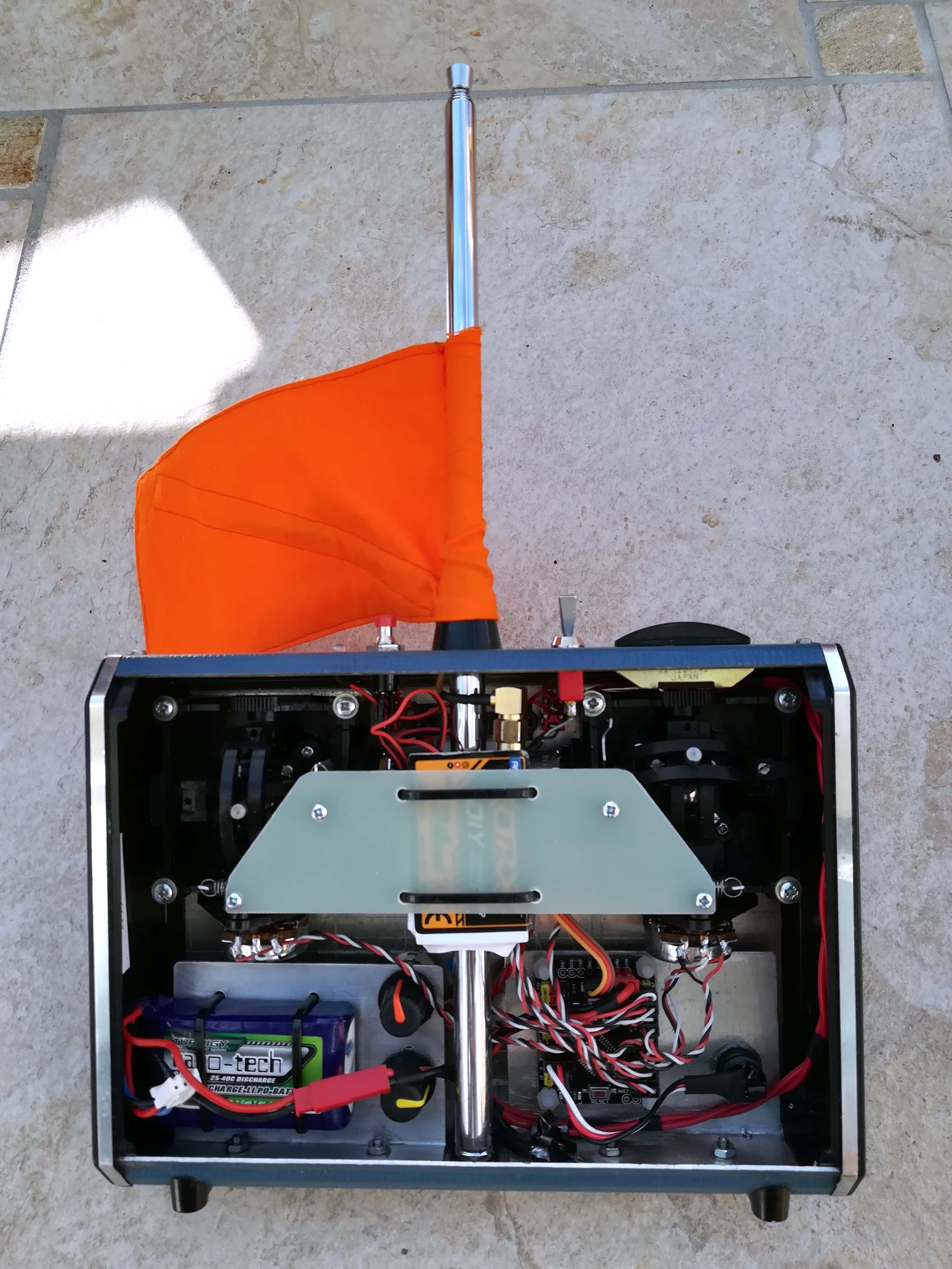

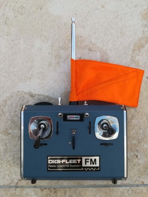

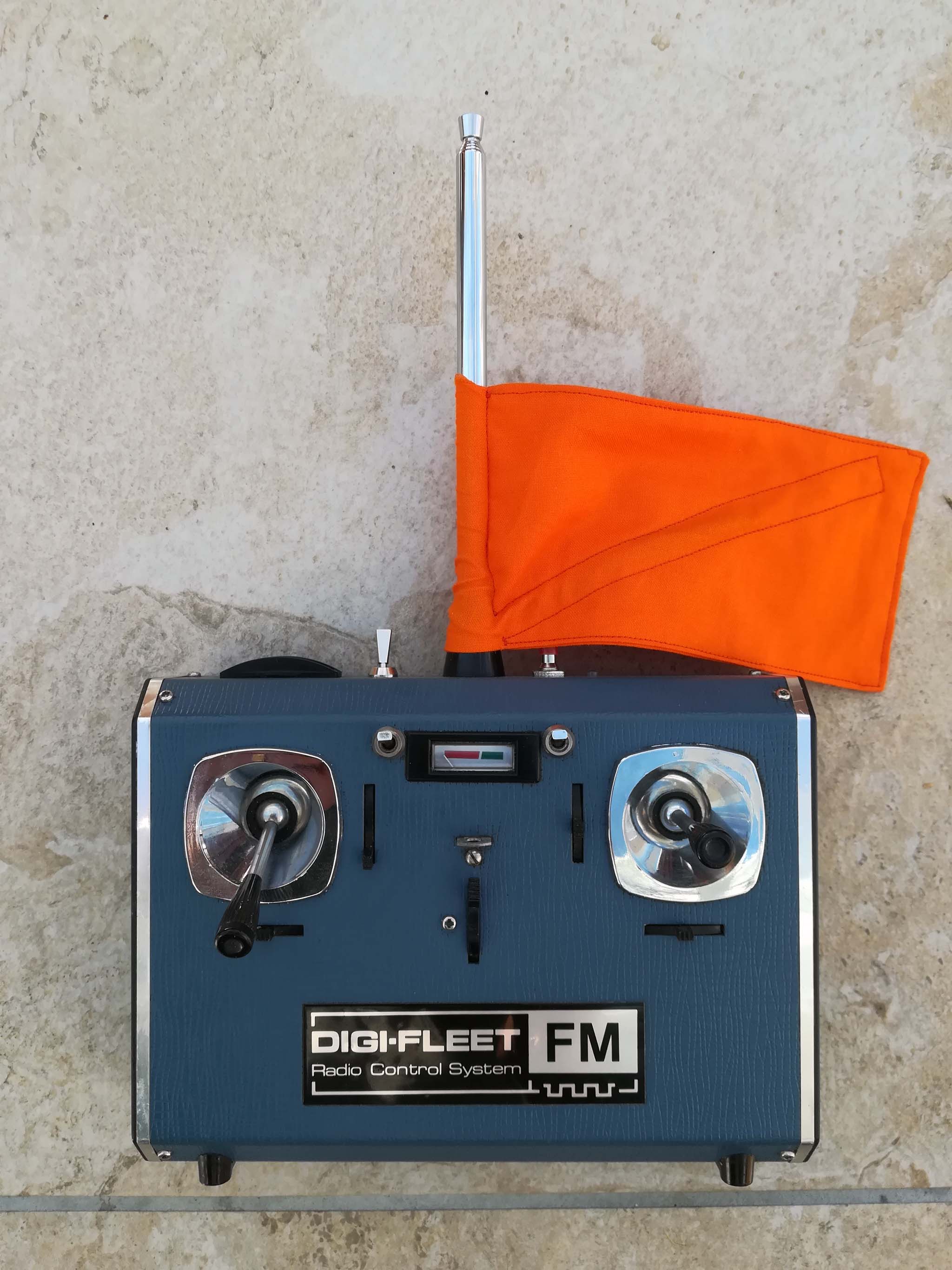

Not sure if it will help but this is my conversion of a 6 channel Digifleet FM...... I think they were all in a similar case?
Phil's Arduino thingy is on the right at the bottom and as you can see, after soldering the leads onto the stick pots and other bits and pieces, it is just a plug-n-go job. In order to keep the outside appearance as close to the original as possible, the rate and expo pots are wired via the original two rate switches either side of the meter. The switched channel is on the original u/c switch on the top of the case. Externally the only thing that is not original is the bind button and little flashing LED which I have sited in the top of the case.
