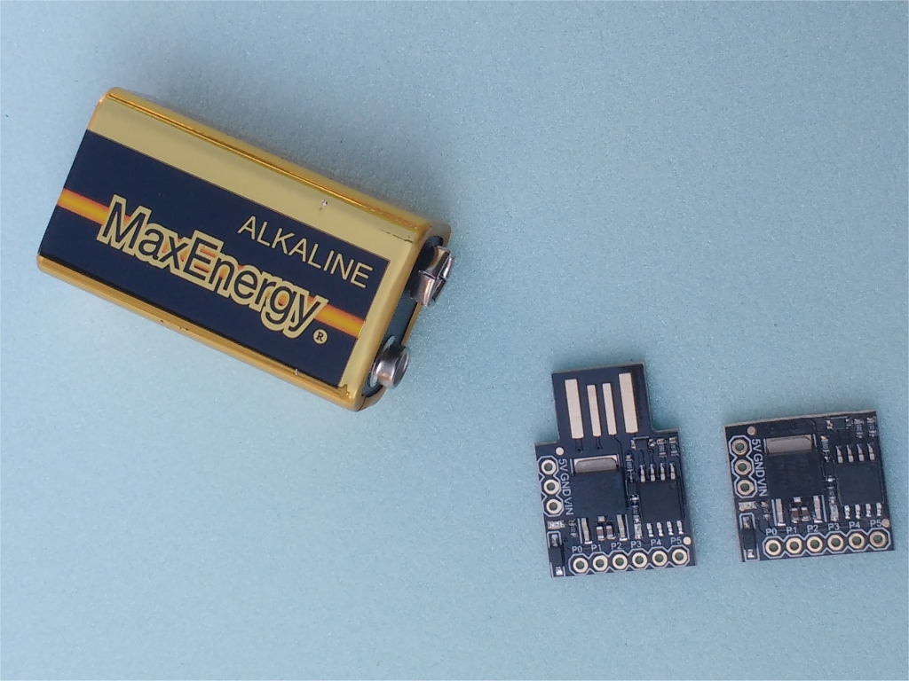

Heres a before & after shot, with a PP3 for size reference - after the mod, they're really small, less than 3/4" square:
Digispark ATTiny85
Digispark ATTiny85

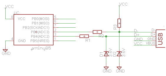

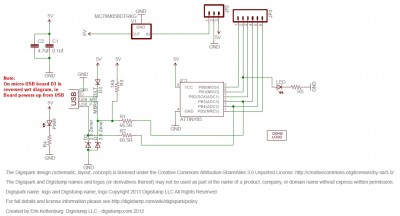

In the case of the Digispark board, P3 and P4 are the USB data connections, and both have some protection circuitry in the form of resistors & 3v6 zener diodes which the 25k internal pull-up cannot overcome. The result is that if P4 is configured as an input using say:
pinMode(4,INPUT_PULLUP);, when open-circuit, P4 will always read as a zero.
This affects only P4, P3 has an additional on-board pull-up resistor of 1.5k and so behaves as expected.
A further effect of this is that when used as analogue inputs, P3 and P4 are restricted to 3.6v max by the zener clamping diodes D1 & D2 - and the additional 1k pullup on P3 affects its linearity as an analogue input - see diagram. In the bottom two photos you can see how the unwanted protection circuitry can easily be removed, if required - physically remove the diode D1 with your thumb-nail, and D2 by pressing it sideways with a watchmakers screwdriver. The lead-free solder is very soft and they both break away quite easily with no need to cut tracks or drill PTH holes! This will remove all the USB protection circuitry around P3 and P4 and revert them to 'normal' ATTiny85 behaviour.
P1 has an on-board LED with a 1k resistor and whilst this doesnt affect its operation as an output, when configured as an input, obviously the resistor and led combination are working in opposition to the 25k pull-up and so needs to be taken into account. Its like the Nano's D13.
P5 is by default the chip reset input and needs a fuse reprogramming to change it to a digital I/O pin, after which, since its no longer a reset pin, the USBASP wont work and a high voltage programmer is subsequently necessary. So unless you're very keen, ignore P5 completely.
As supplied, P0 & P2 are the only 'clean' pins with nothing attached.

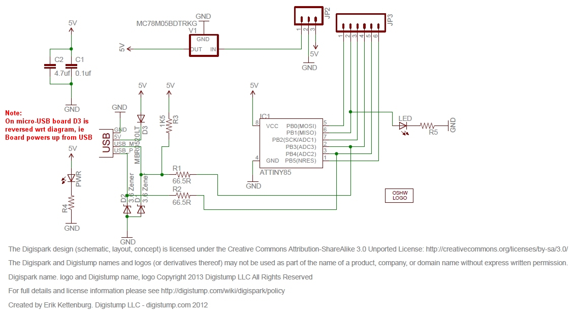

Full schematic of the Digispark board
Remove D1 & D2 from USB connections

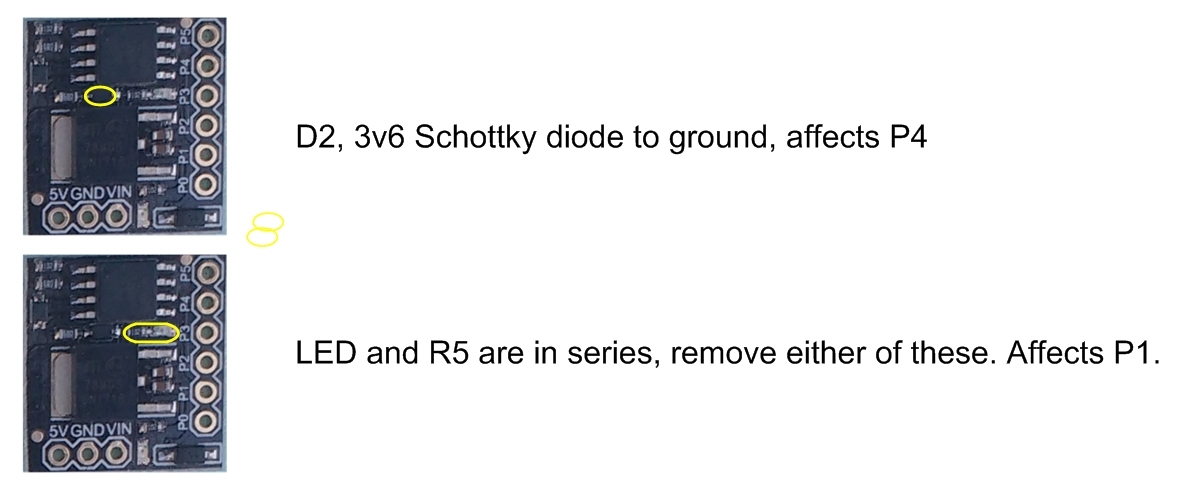

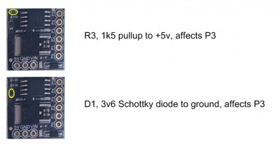

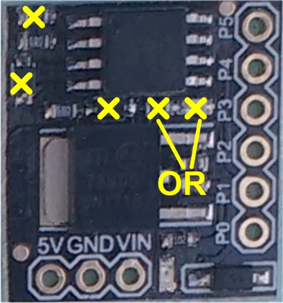

“De-fluffing” a DigiSpark:
As can be seen in the diagrams above, some of the DigiSpark pins have additional circuitry on the PCB which we need to remove as it affects the linearity when those pins are used for joystick inputs. Three pins are affected:
P1 has an LED with a series ballast resistor (R5) to ground, this distorts readings when used as an analogue input.

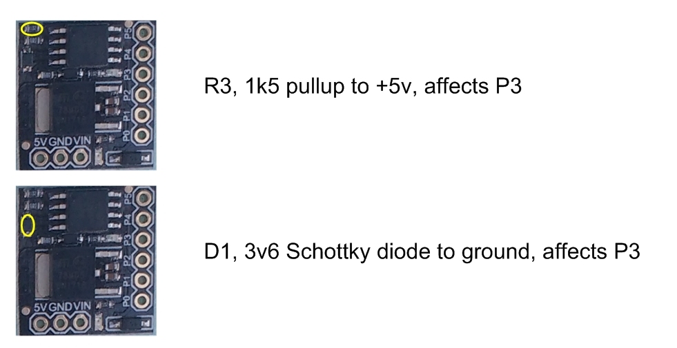

P3 has one of the two USB data connections and has a 1k5 pull-up resistor and a 3v6 zener diode (D1) to ground.
P4 has the other USB data connection and has a 3v6 zener diode (D2) to ground.
These components affect the linearity of the P1, P3 and P4 when used as analogue inputs and in the case of P3 and P4 actually limit the maximum voltage that can be read.
Luckily these unwanted additions are easily removed - but first to identify the culprits: (click to enlarge)
Remove the marked components using a jewellers screwdriver, they should easily flick away, but a stubborn component can be gently ‘chiselled’ to break it up. Remove either one of the two components nearest P3, the LED or its ballast resistor – I always go for whichever has the least solder.
Again, I stress, this is really easy to do and takes seconds, in fact D1 and R3 can be liberated with just your thumbnail! The final 'de-fluffing' is to saw off the USB tab. Dont worry, there are no traces or connections there to worry about, it can safely be removed altogether, flush with the edge of the board.

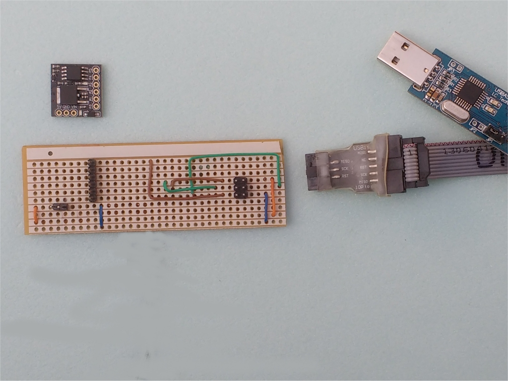

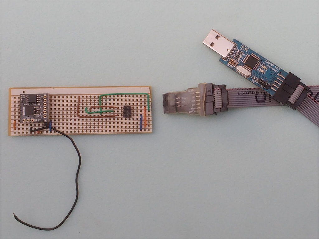

Heres the programming adapter - just two headers on a length of vero for the chip and the usual 6-pin USBASP header:
Programming adapter
Programming adapter
I later added an extra header pin on the neg rail, so my PPM tester plugs onto neg & port P0 (ppm), and also a resistive ground-lead for testing button inputs. This means the programming adapter doubles as a simple tester:
Programming adapter
Programming adapter
The board is a loose fit over the headers of course so a small sponge block under the top-left corner wedges the board at an angle and secures the connections.
One thing I have noticed is that although the clock speed is stable, its not precisely the same from one chip to another, at a nominal 16mhz some are very slightly over, some are very slightly under, but that hasnt been a problem as the variation is minimal and for anything 'timing critical' the clock can be tweaked in the software by setting 'OSCCAL'. Its because the RC clock is actually 4mhz multiplied up with a PLL
so any slight variations are multiplied four times.

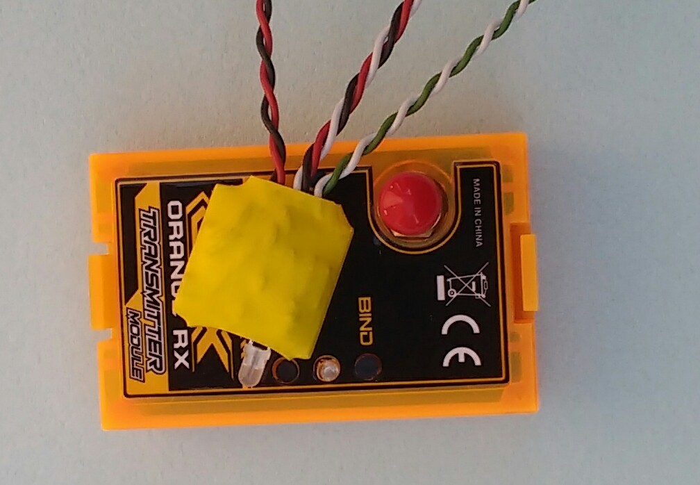

Heres an RDT encoder made with this board (Remote Dethermalizer) for free-flight models, with a Futaba-style OrangeRx module for size:
Remote D/T encoder
Remote D/T encoder

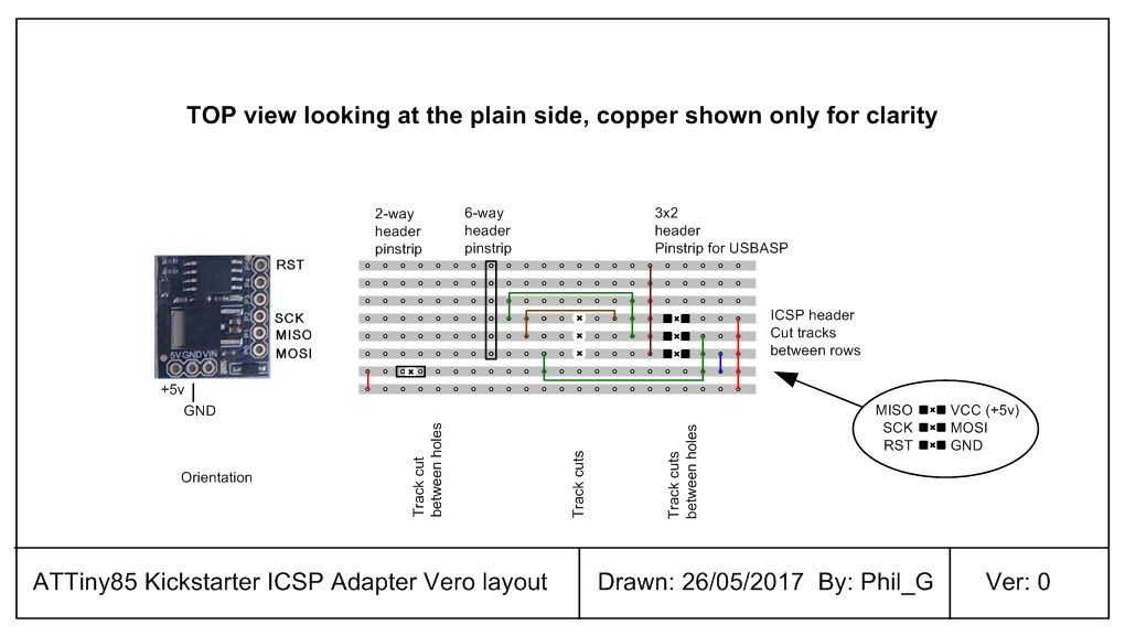

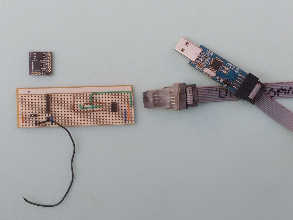

Here is a Veroboard layout. Note that the USBASP header has cuts between adjacent holes, as does the 5v and 0v connector for the Attiny. The short blue link (negative) on the right and short red link (pos) on the far left can both be just a solder blob.

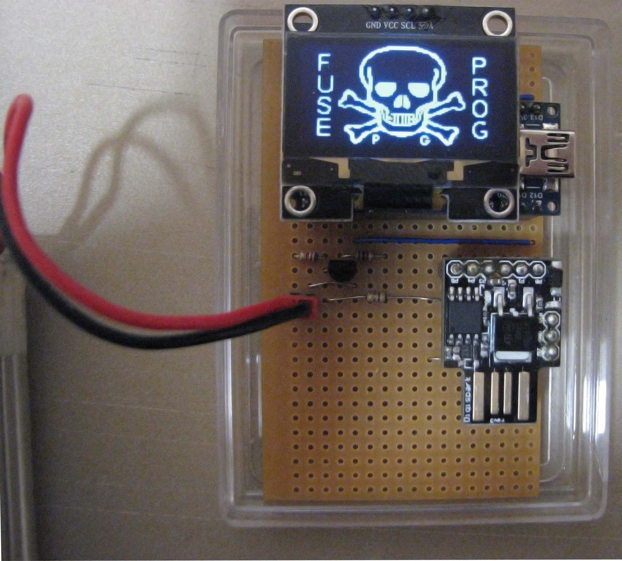

Here's a cheap and easy-to-make fuse programmer, allows use of P5 on the DigiSpark board:
http://mode-zero.uk/viewtopic.php?f=41&t=643

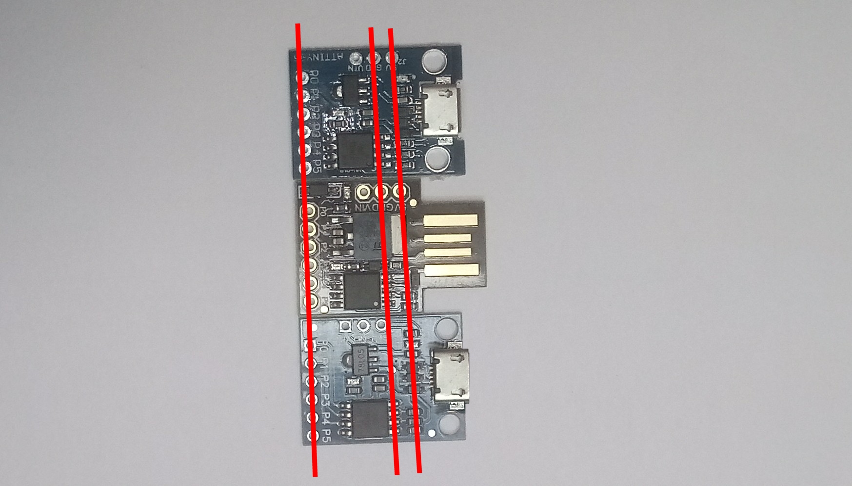

@Phil_G: I think there is an error in the veroboard layout in the opening post. Unless there is a variance in the pinout arrangement of the Digispark boards (I don't think so), the pins for the 5V and GND connections and the track cut in-between should be moved one position to the left.
Max.
Re: Digispark kickstarter ATtiny85 & ICSP programming adapter
MaxZ wrote: 05 Jul 2019, 08:14 @Phil_G: I think there is an error in the veroboard layout in the opening post. Unless there is a variance in the pinout arrangement of the Digispark boards (I don't think so), the pins for the 5V and GND connections and the track cut in-between should be moved one position to the left.
Max.
Max, I'm not aware of any variance within the Digispark ATtiny85 boards (doesn't mean that there aren't any :( ), but there is a variance between the Digispark and some other manufacturer's ATtiny85 boards. See my post in thread:
viewtopic.php?f=25&t=587&start=10#p4641

Wayne_H wrote: 05 Jul 2019, 14:01 but there is a variance between the Digispark and some other manufacturer's ATtiny85 boards.
So I see. But this topic is about the Digispark, so I guess my comment is valid....

My apologies Max, you are quite right. I have updated the vero layout diagram.
There is indeed "a variance in the pinout arrangement of the Digispark boards" - there is at least one non-standard variation of the DigiSpark board which has an onboard micro-usb shell, and that has the vin, ground and 5v pins offset towards the P1:5 edge, like the bottom board in the pic.
By chance my very first DigiSpark was this version and the vero layout was drawn accordingly. Since then I've bought maybe 200 DigiSparks of the original 'tabbed' style and the photos show the adapter correctly spaced for these boards (as does the vero layout now!)
The DigiSpark referred to throughout the post is the original 'usb tab' version from the original Kickstarter files, the one in the middle of the pic, and the one we're generally using now - but I'd forgotten that the vero layout drawing needed changing.
With other versions the headers might need shifting, depending on the particular board, some are standard, like the top one in this pic, and some are not, like the bottom one Image
The 'real' one (middle of the pic) has advantages - its smaller when trimmed, its easier to defluff and it has a 1A regulator so it can power for example a Flysky RF module. Hence its the board of choice Image
Again, my apologies and thanks for picking this up Max.
