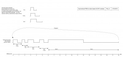

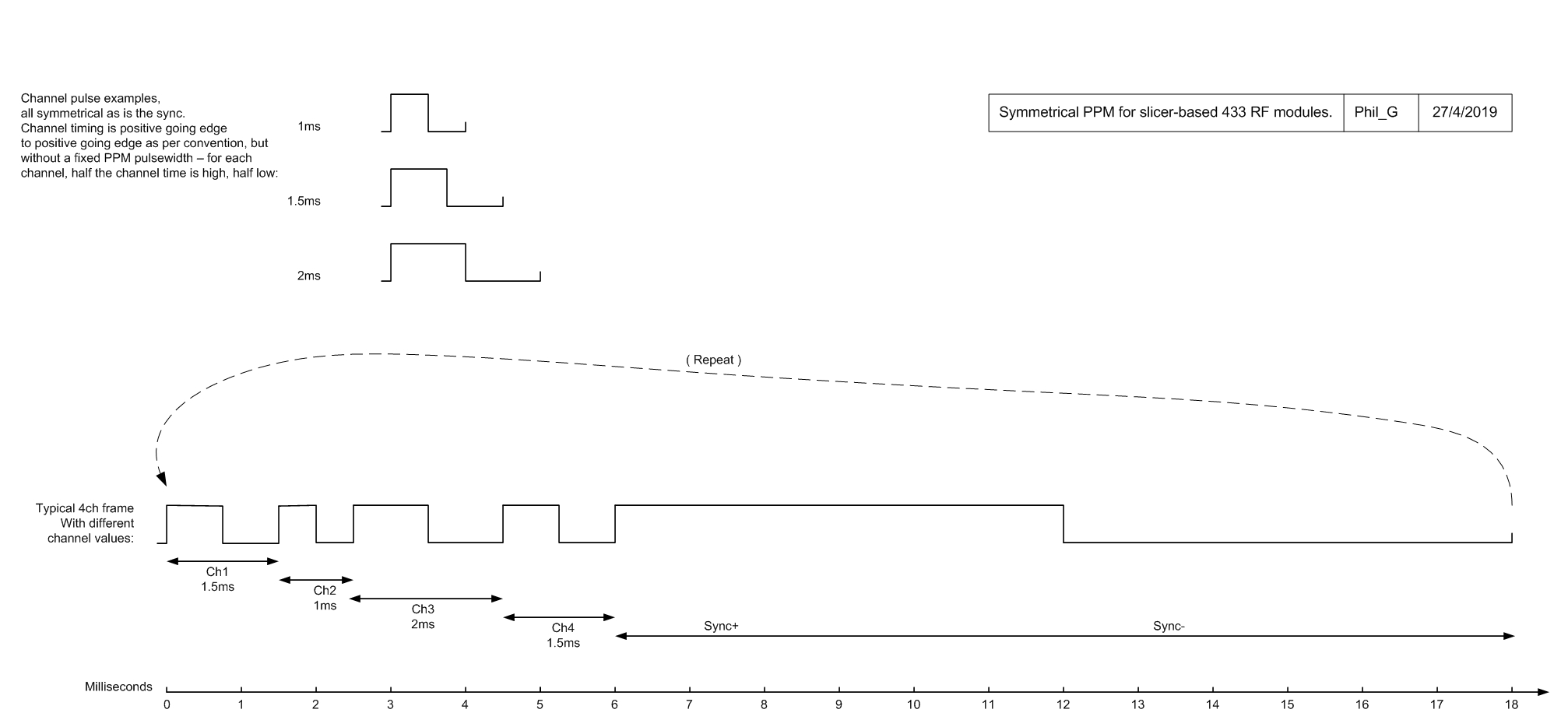

The diagram shows a typical 4-channel frame but you can get say 7 channels into a 20ms frame.
