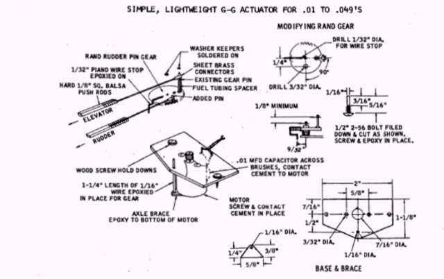

In his “archive” I found this poor old photocopy in how to build your own mini/micro GG actuator. This didn’t surprise me as Dad often spoke how they flew with small home-made actuator utilizing some gears from servos for the time quite small models and throttle control was not an essential commodity….
As I study this photocopy and some scribbles on the back, at last I understood what he meant as I have never had the opportunity to see any of this “original” actuator, anyone have an idea where this page came from?

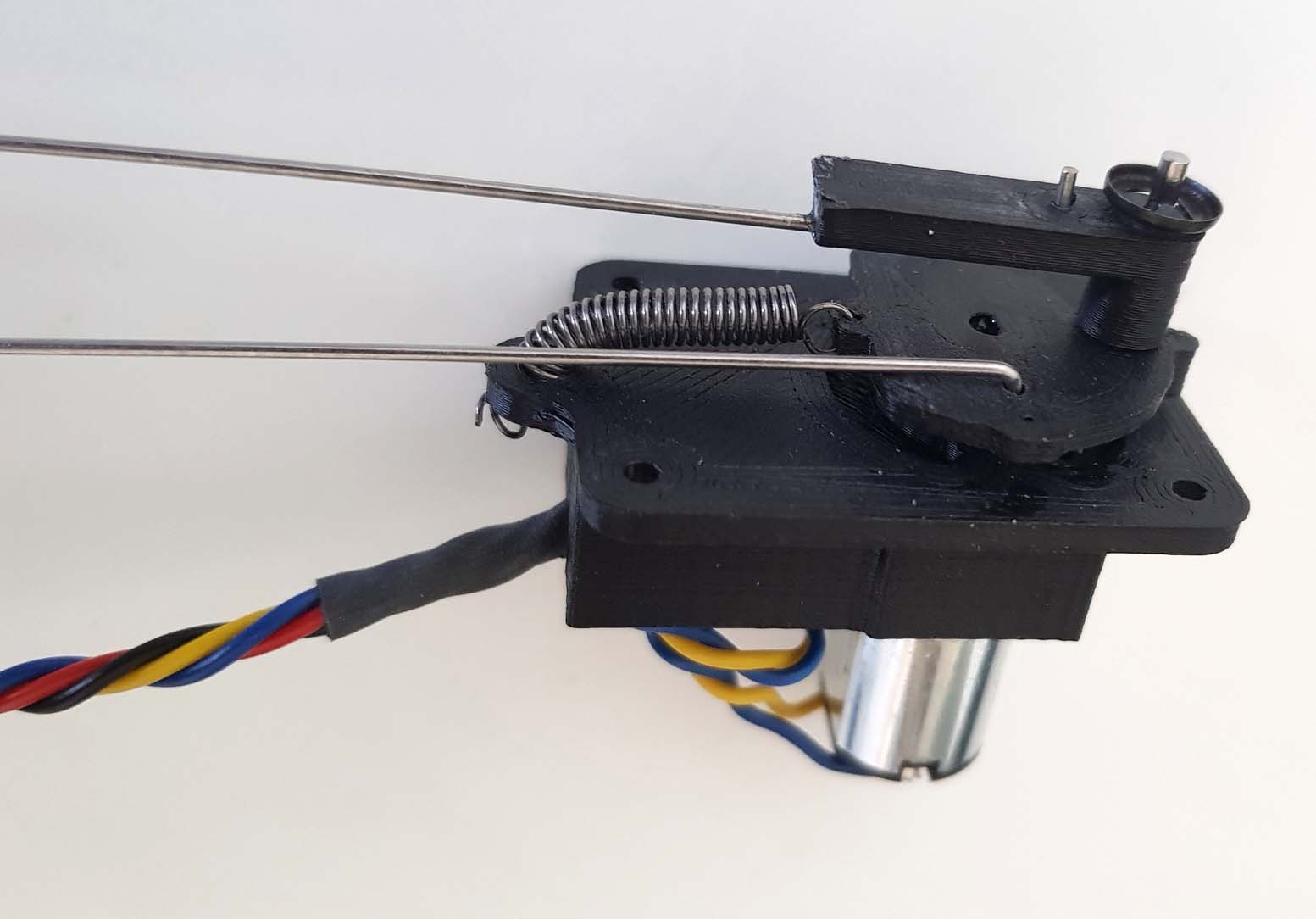

The original design is based on the main gear from a Rand actuator mounted on a small plate modified accordingly. What comes out is a tiny actuator with extremely few moving parts.

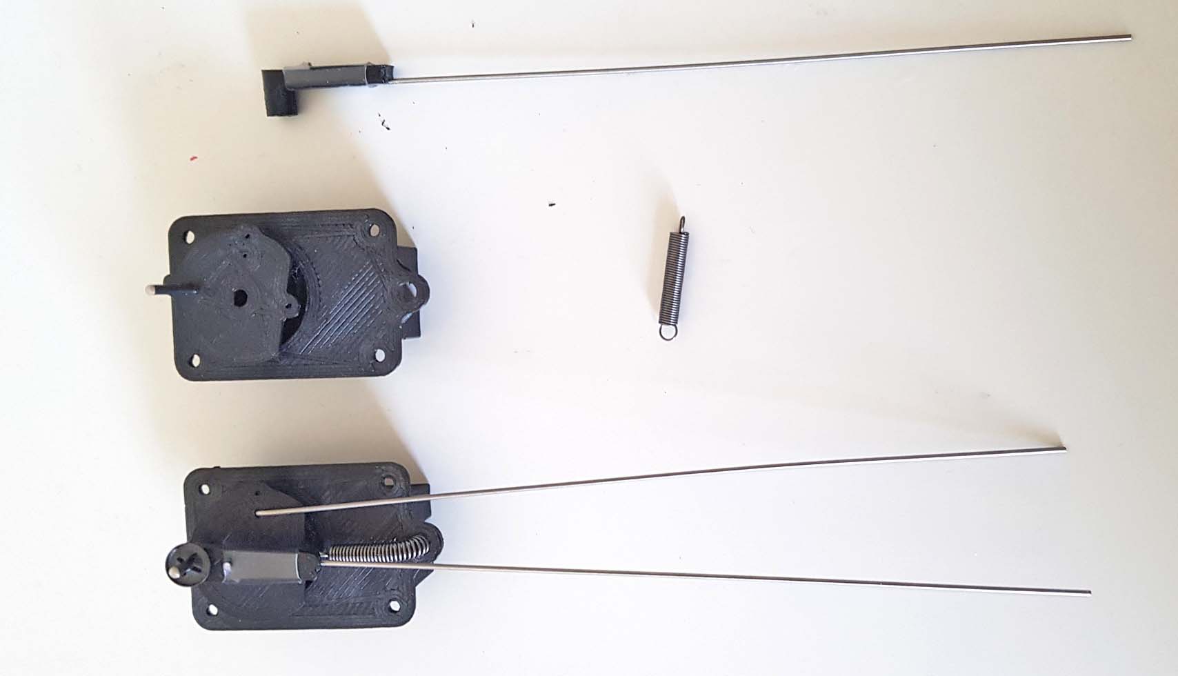

So, I started to create a proper base and a Rand kind main gear to have a suitable platform to work with and slowly build on all function. What differ this actuator from original Rand/Controlair is that it can’t be allowed to cycle so, from the beginning it is only intended to have 2 functions Rudder & Elevator. From the original sketches I couldn’t figure out a possible spring and to be honest I’m not sure they used one.
After some experimenting, I came up with this actuator which I would call a “Combo Actuator” as it can be used both as single-channel as multi-channel.
In single-channel mode no spring is necessary as it’s equipped with end stops like the Adams Clone but in the multi-channel a spring is added despite the need of end stops plus an “elevator clips”….if you set your regular GG recoder rate - elevator - to a fix value by connecting it to an AUX channel you could use the same recoder both for single-channel as multi-channel by just swapping from an AUX channel to elevator.

….and last, yes it has been flown in a PageBoy as the size & Wright is the same of a regulat Adams or my Clone actuator

Original article for Mini GG actuator

Thank You, you made my day.
It all make sense as Dad was an avid user of ACE's electronic/designs as I'm almost sure he flew it with a K3VK receiver with the addition of a small pulser.
Original article in RCM 1967 February, found the magazine both in Dads boxes but also here

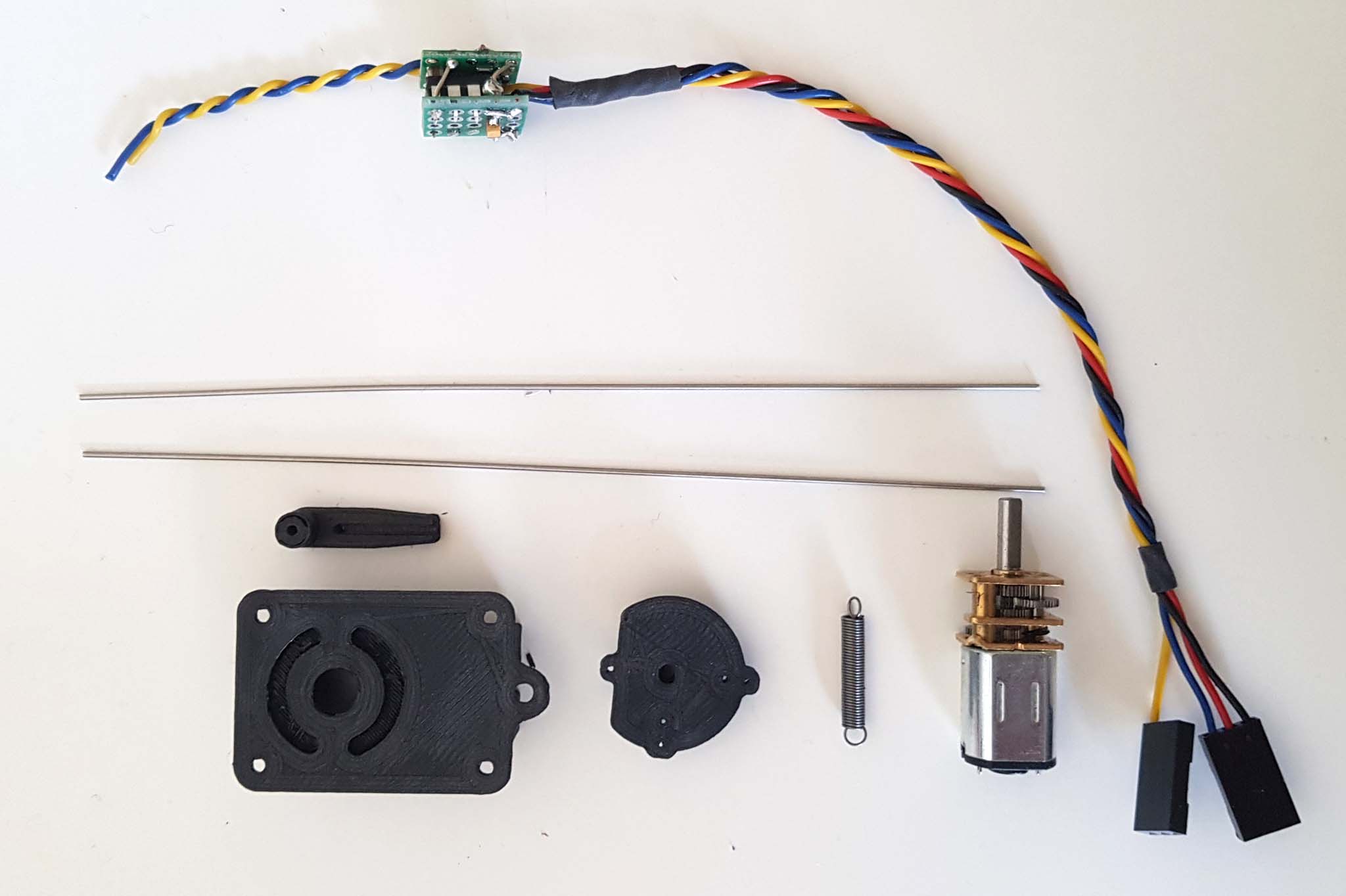

There are so many variants of those micro gearmotors. Can you confirm which one you are using for GG on 2S ?
Is it the 6V 600rpm one ?

I use several different gear ratios based on the set up and I also get from my supplier a motor set for 4,5 volt. 600 rpm at 6 volt sounds on the high side but not to much far off as a normal Rand gear ratio gives around 300-400 rpm in an unloaded condition but this is based on their pulse rate. The secret here is to get the set up to change direction due of spring or end stops very close to when the pulse reverses otherwise your motor will go unnecessarily hot reducing life span of the motor itself.
Not all motors are able to reverse at this kind of pulse rate and will just stand still. In the development of the GG-Tobe I have must tried 10-15 different motor/gear box ratios/combinations.
It has to be kept in mind that in this kind of "modern" actuator are using a high rpm/high ratio gearbox compare to the original ones that used a low rpm/low ratio set which might call for special attention in some details like the choice of the centering spring.
