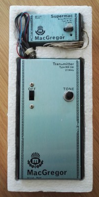

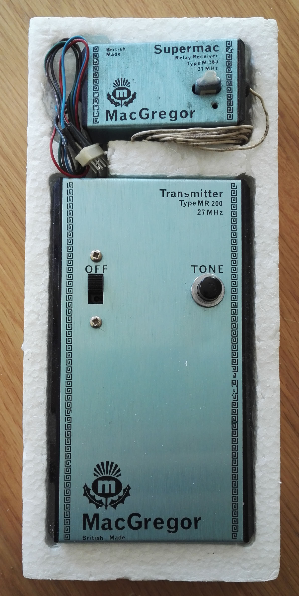

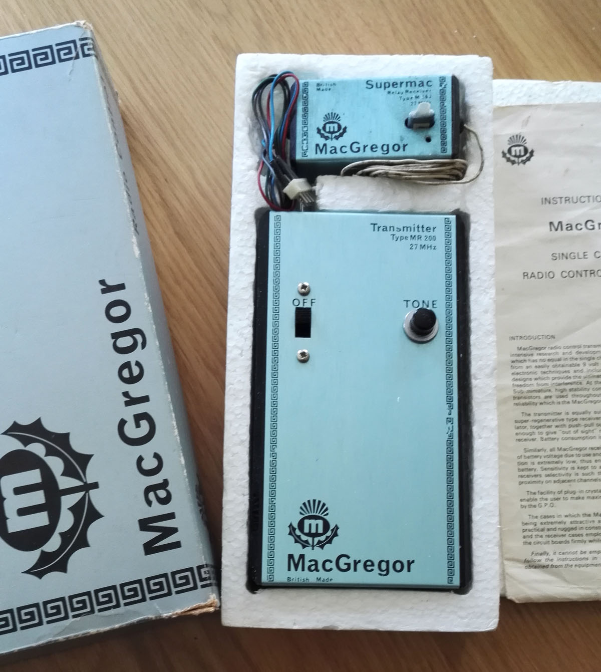

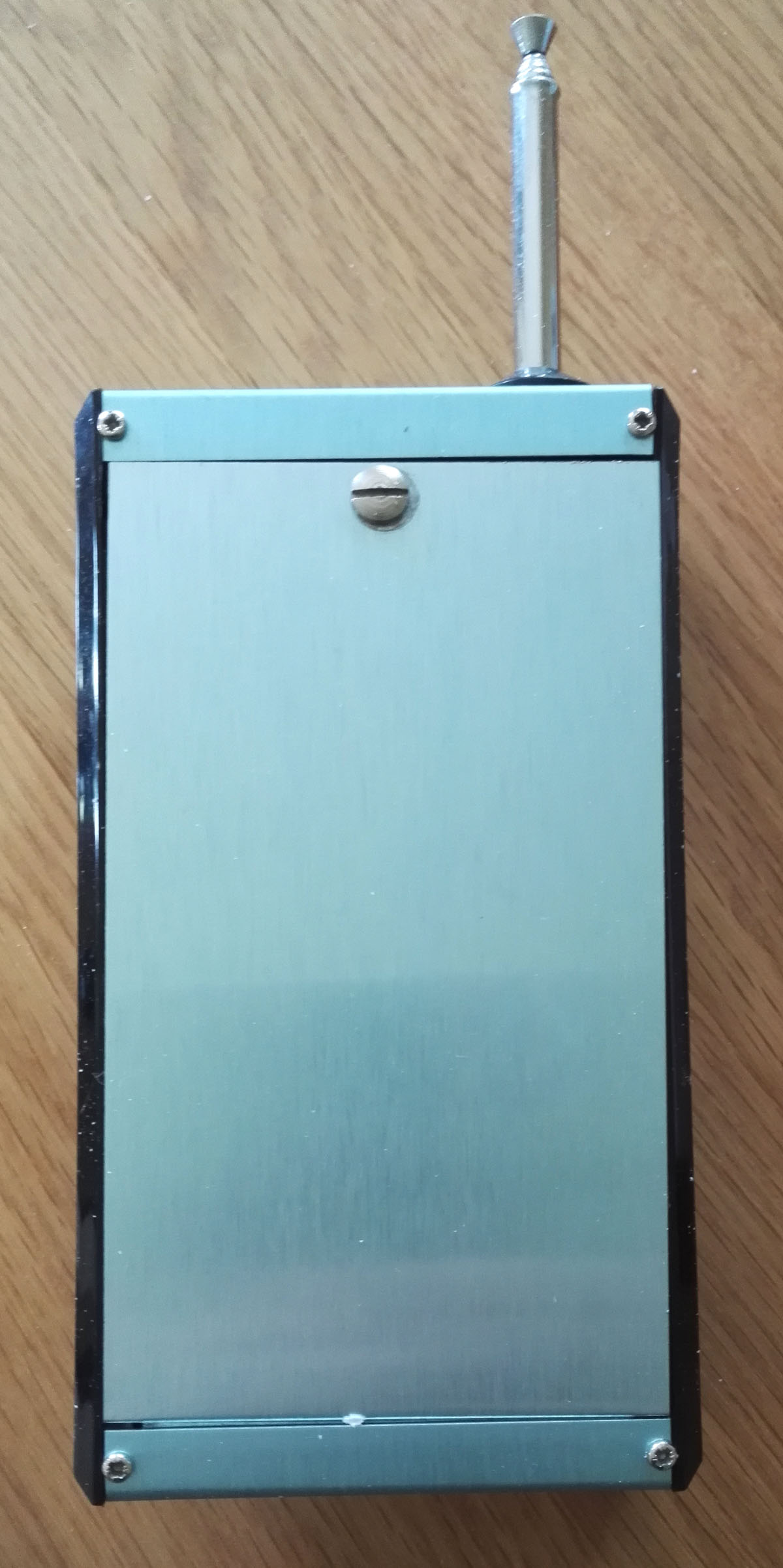

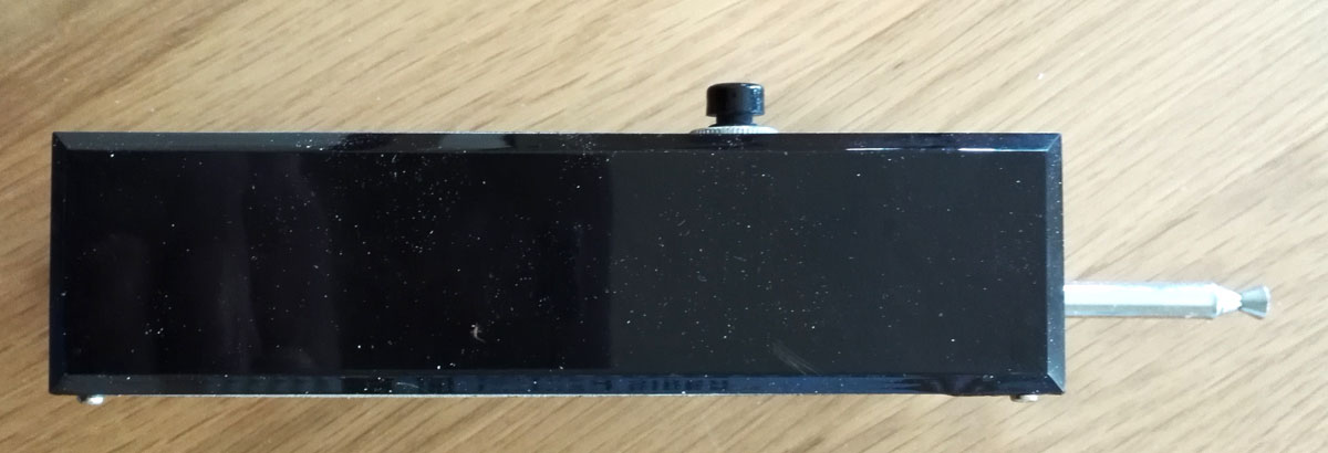

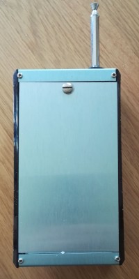

The overall dimensions of the MacGregor MR200 are 152mm (H) x 85mm (W) x 40mm (D). I've attached a couple of photos, you should be able to scale things from there, such as the switch positions etc. The construction is blue anodised aluminium case with plastic end caps.
