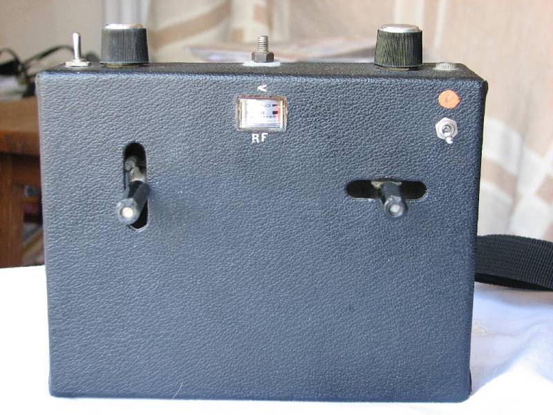

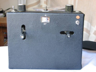

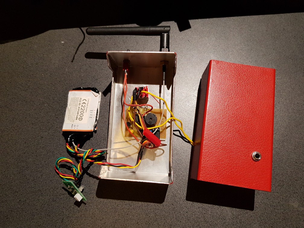

Erm.... my 1970s home brews were folded up from sheet using my Dad's carpentry vice, angle-iron offcuts and tinsnips. No sheet metal tools, no folding machine, no guillotine. Covered in sheet vinyl with Evo-Snot (note the overruns!)

Re: Folded aluminium transmitter cases

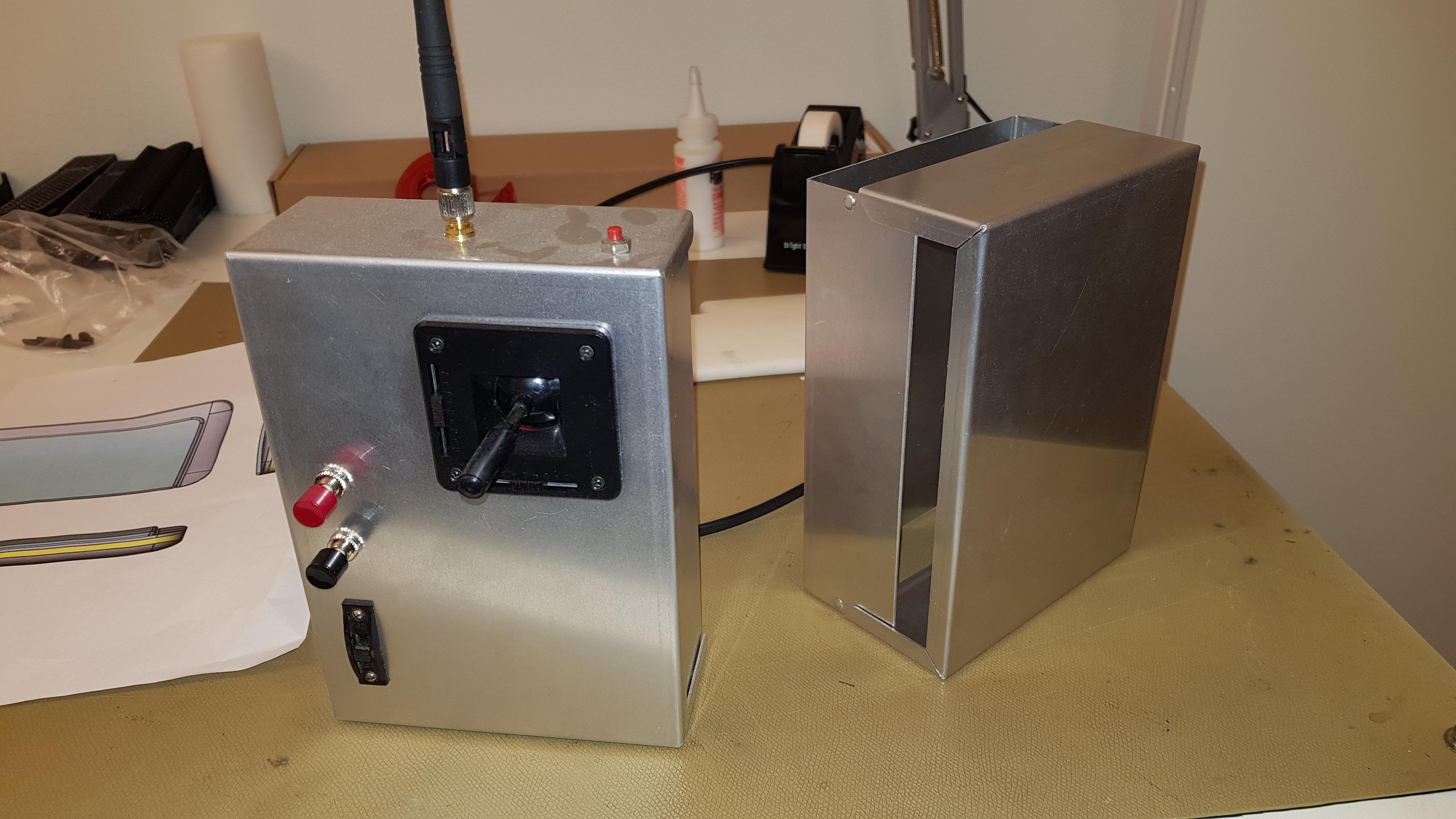

I've made a few with a cheap pan break in a vice...
https://www.ebay.com.au/i/254367817580? ... id=7364522
The results are pretty good & you can cover with ebay vinyl for a retro look.
Al
Al
The lessons I've learned are as follows.
- Make one out of cardboard first to make sure it all fits
- Drill a 2mm hole at the corners to get a nice neat corner
- Bench shears twist the aluminium too much, use tin snips
- Sand all of the edges with 240 grit or you'll cut yourself
