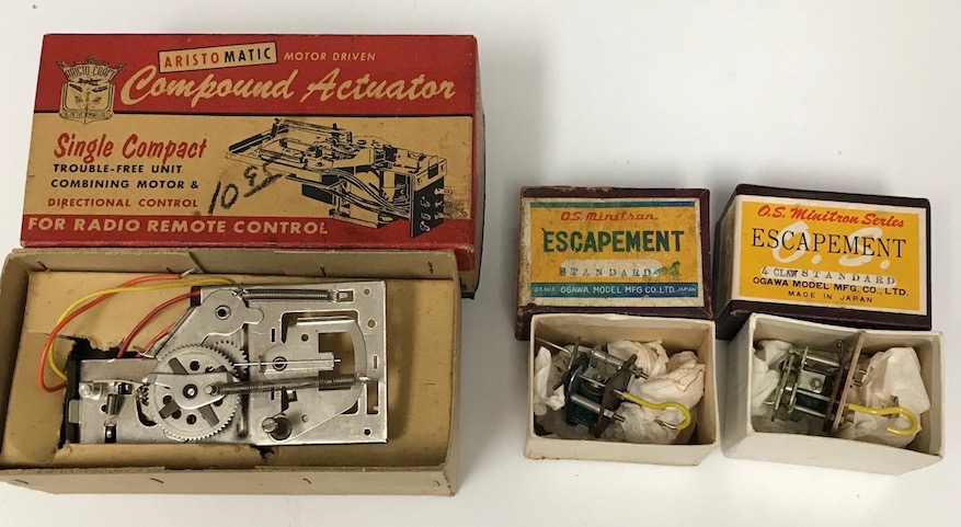

This may have been answered and Phil probably already has something but I couldn't find it. I want to put an original escapement in a small model and control it with modern RF/receiver. I want to do the whole rubber band thing :)
Can anyone help with a small circuit to take the PWM (?) signal from a modern receiver and turn it into the On/Off to control a classic escapement? I realize its kind of like turning AC to DC and back to AC again but it lets me use the simplicity of Phil's PIC encoder or an Arduino and a modern RF module and receiver to fly an actual escapement.

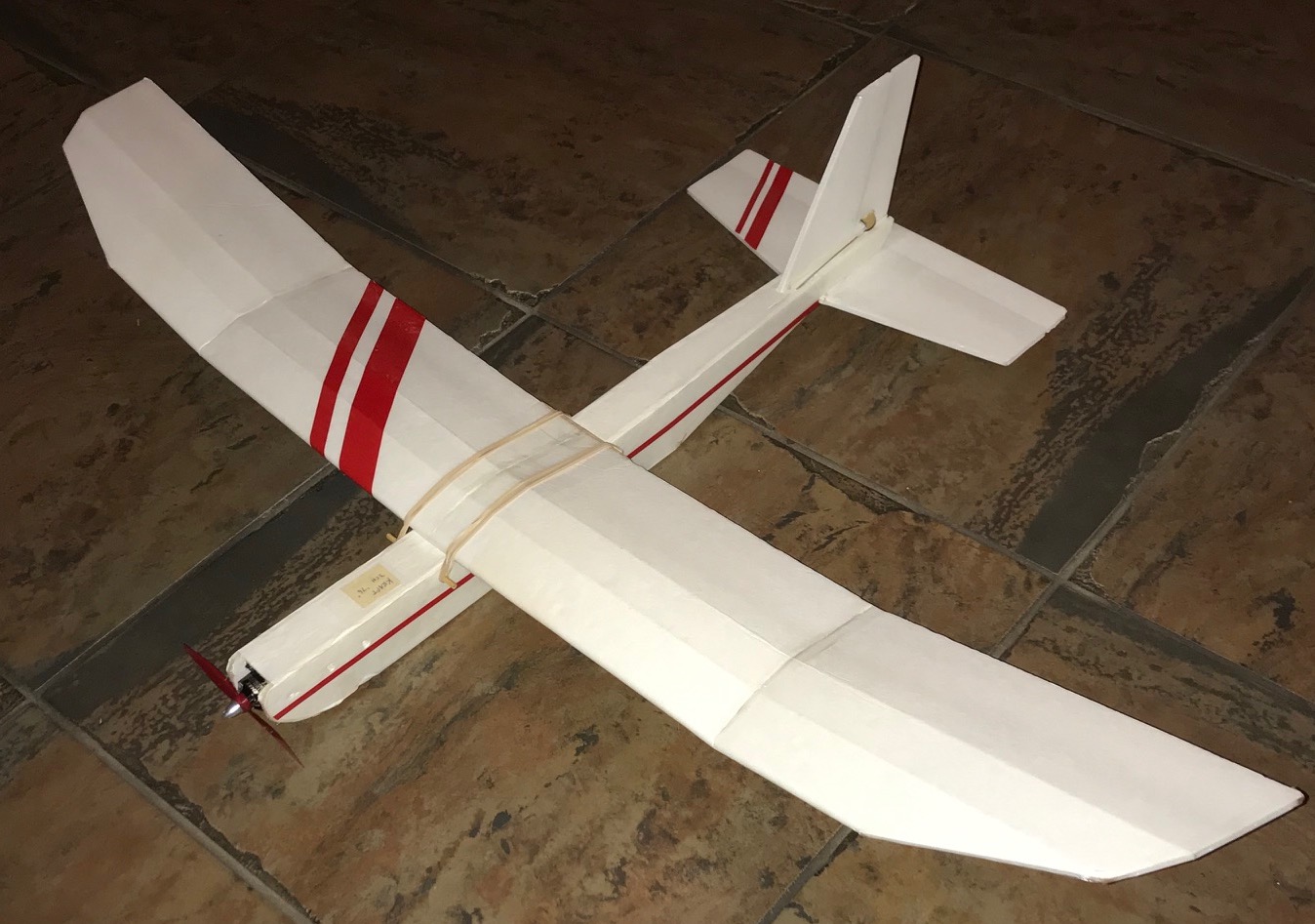

I really want to play with these actuators I picked up from Internet. There is probably a better place to post it but this is a little foam board airplane I test all my radio stuff with. It started life as a Flite Test Tiny trainer and has evolved over several iterations to suit me. It weighs 7 ounces. It uses a 250 size quadcopter motor and a 5x3 prop. Anything from a 300-800 2S or 3S lipo flies it great. Its a total blast. If I lived near a slope, I would have a round nose version ;)
It may need a slightly fatter fuse to contain the small escapement but I can whip one up and have it ready to fly in an hour or so.

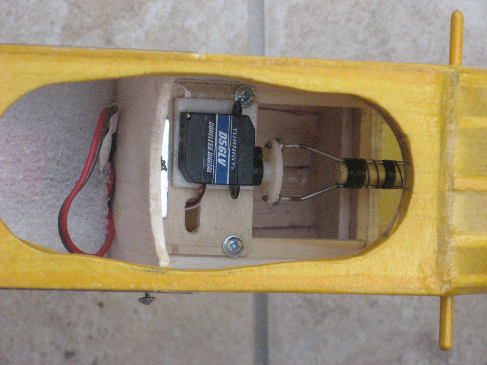

However, it's worth repeating the warning Phil gave me several years back - The switch is purely for escapements. Actually I would strongly recommend you leave the escapement idea to one side for a while, call that plan 'B' and go with the emulation. Fifty-year old escapements just aren't reliable enough and I'd hate to see an accident caused by a sticking escapement - we live in litigious times and a claim could be expensive. The whole point of the 2.4g S/C project is that its exactly the same experience but absolutely 100% reliable - which an escapement can never be.
I have several escapements and will eventually fly one just to be able to say "I did it", but it's hard to go past a modern servo rigged with a torque rod to emulate the escapement's operation - that I have done and it works beautifully :D

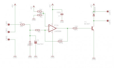

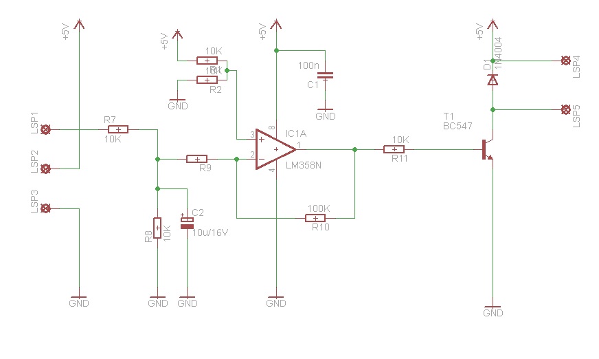

I have a few mechanical actuators too and wish to do the same as you. The original 'switch', Graupner, etc, are based on a 358 op-amp. It is just an integrator, very simple but also very slow, not really suitable for a mechanical actuator. The newer Hobbyking versions are probably based on a micro and would be much faster with a bit of de-bouncing too. It might pay to buy a few and see which are best.

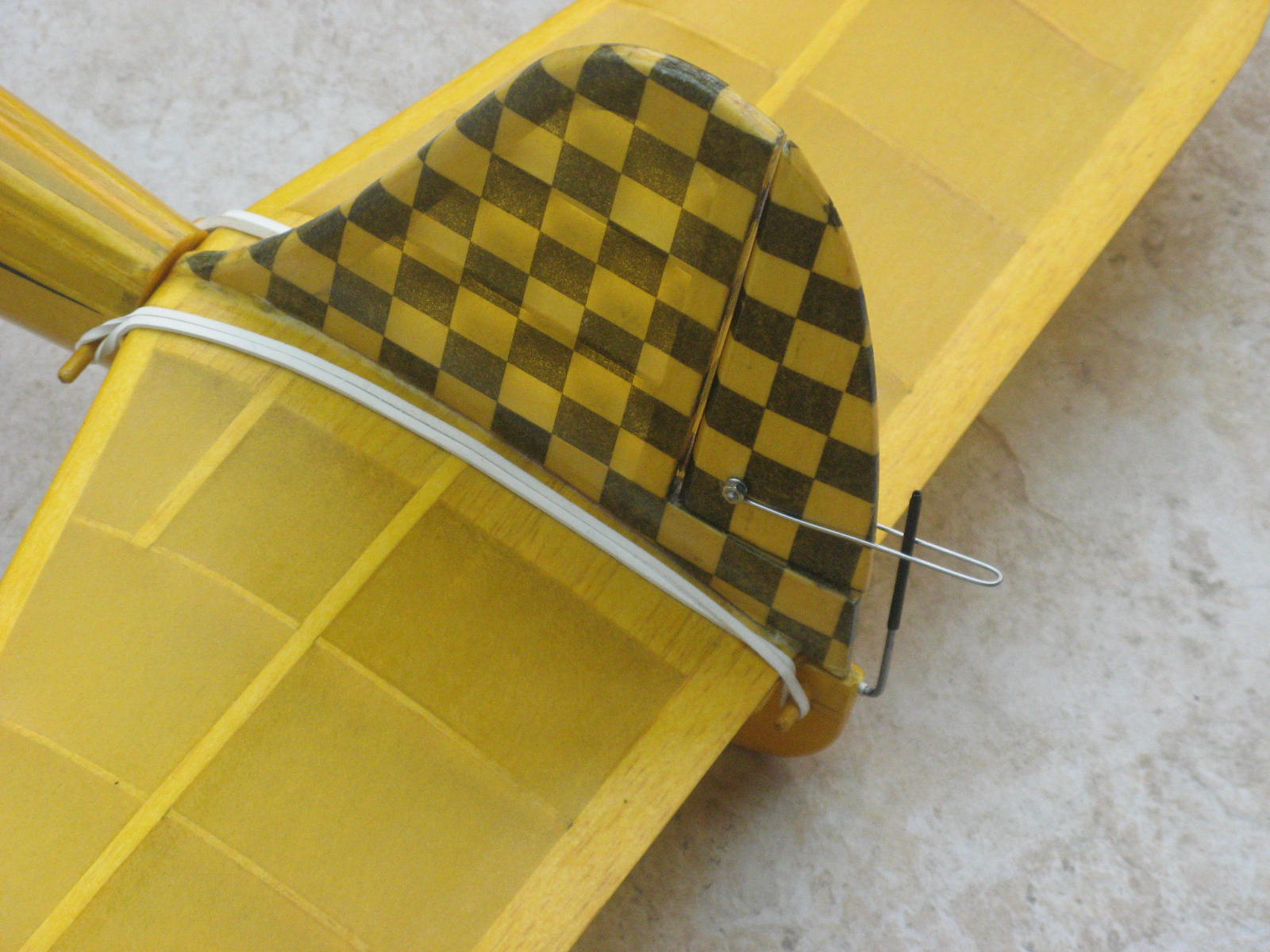

Having "been there, done that and ticked the box", I can only echo what others have said...... By all means play with them on the bench but the bench is where these contraptions should stay! Escapements, and particularly OLD escapements are notoriously unreliable and have cost me several models and much loss of pride! Phil's system of a servo, driving a torque rod works beautifully! On the ground you can't tell the difference and in the air it works EVERY time and when you crash, at least you know it was your fault and not that wretched skipping escapement!.......
