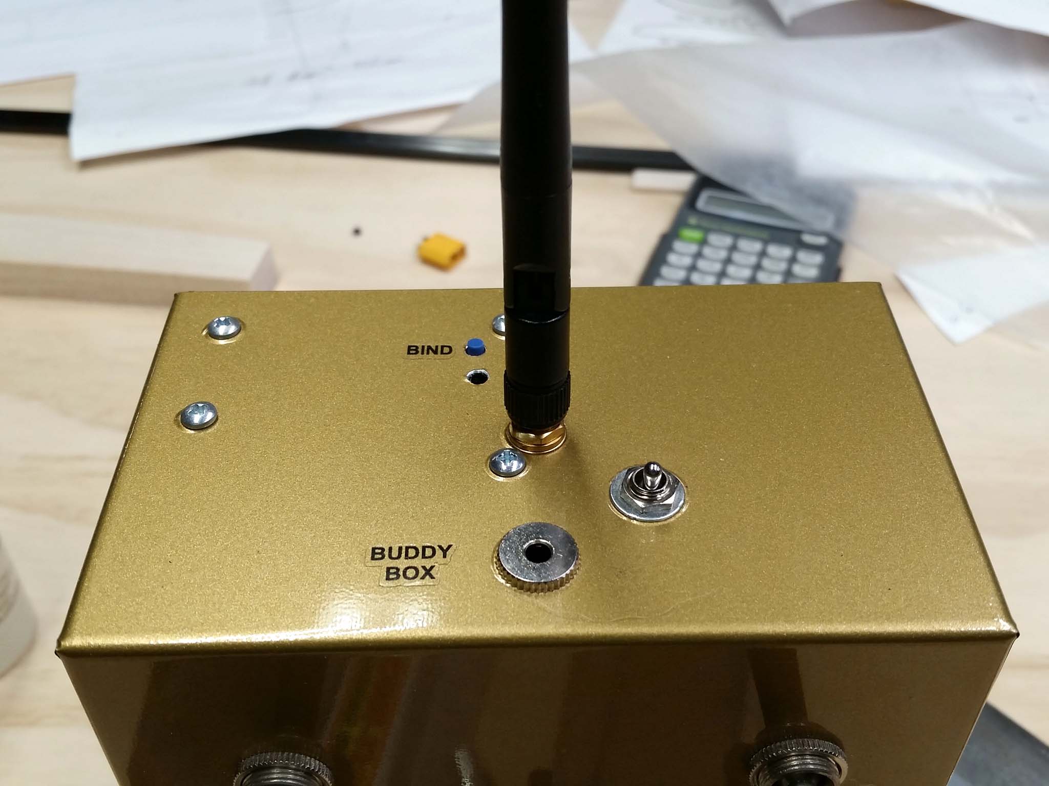

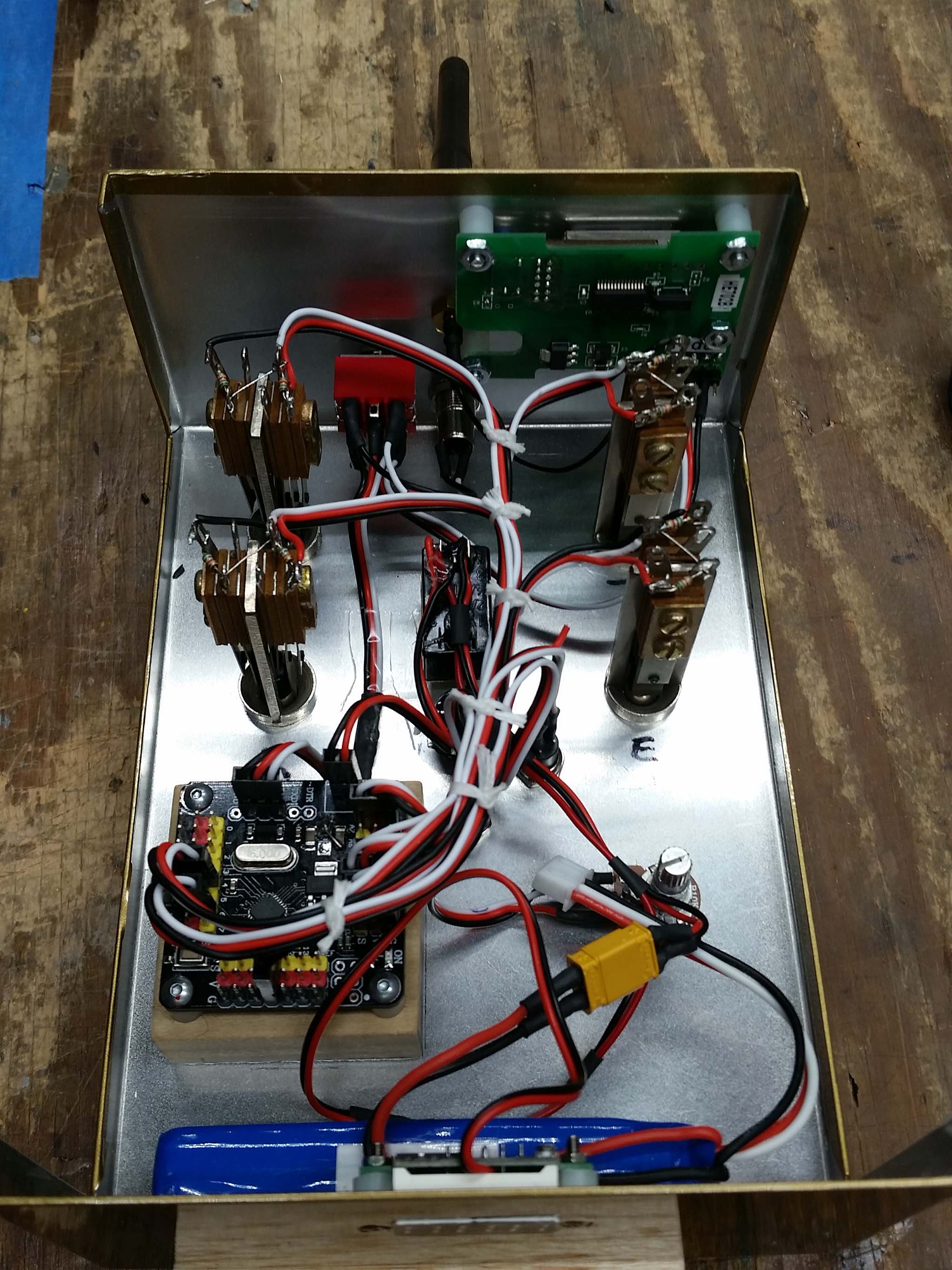

It is unclear to me how the 2.4GHz module in the reed transmitter gets shut off when the Master transmitter is in use. There is no switching circuit I can see that would interrupt the modulation to the reed transmitter's module. I plan to use a DX-6i as the master for proportional flying, and the reeduino, or PhilG reed emulator for the reed box.
Maybe somebody here can shed light on how the buddy box feature works with a Reeduino and the Phil G reed emulator.
Is it just as simple as unplugging the 3 pin plug from the module to the Pro Mini-Strong board to use it as a buddy box? If so, I did not see any reference to so doing.

I don't think you want to shut down the 2.4GHz module. The receiver is bound to that one module and that module has to keep transmitting. What you have to change is the signal - PPM or whatever - that feeds into that module.
That's the way any buddy box system works, as far as I know. Even the old long antenna sets on 72MHz or 35MHz or whatever didn't change between two transmitter modules - the same transmitter HF module always controlled the plane and the buddy box system just feeds that HF module either with control inputs from the master set, or the slave set, or some mixture of the two.
I think the only way to switch between two different transmitter HF modules would be to have two receivers on board the plane - one bound to each module. Then you could have some circuitry on board the plane to recognize that one of the transmitters was no longer transmitting, and switch over to the other one.

I haven't documented it cos to be honest I'm not a huge fan of buddy-boxing Jay, and I always try to persuade others not to... its just too much faffing about with trims and throws and reversing and matching up and "you have control" nonsense and wires all over the place, its all just too distracting. A wireless buddy is better but it gives the mistaken impression of flying solo. My own view is that a nice stable model with a dedicated reeds transmitter is a much better idea.
If I did use a buddy, I definitely wouldnt use a cable, I'd use a CPPM receiver on the master. This would also get around the troublesome Spektrum 400uS PPM.
I'm not sure why you're so apprehensive of reeds Jay, theres no need to be, its really very easy to fly and a competent flyer like yourself will be fine without a buddy box! I would suggest you forget the buddy box idea altogether, you'll be fine and you'll enjoy it all the more knowing you are solely in control
Will any other reed flyers back me up on this please? its no harder than flying propo is it?

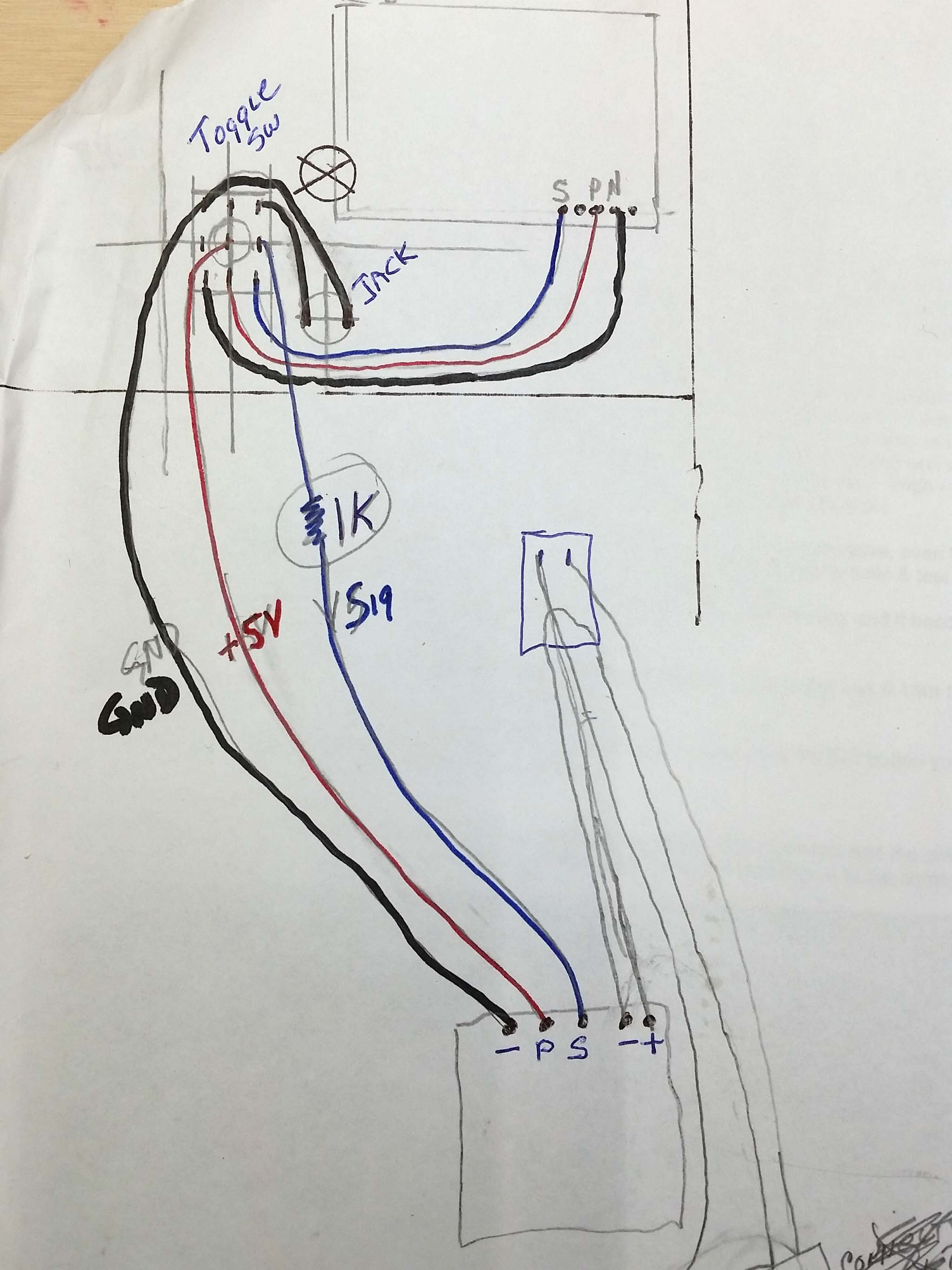

PS if you absolutely must use a buddy lead, then yes, take the PPM output from the encoder (D0) to the common of a two-position change-over switch, with one side to the RF module and the other side to the trainer port output. If you want to disable the RF (why? no need...) then use a two-pole switch, one pole changes over the PPM and the other switches the RF module power.
But really, the whole buddy thing... I wouldnt bother

Maybe I misunderstood.
If the reed set is going to be the slave, there's no need to shut down its 2.4GHz module. The model will be bound to the module in the master transmitter - what does it matter if the reed set module is still transmitting? It's a little extra drain on the battery, and one more 2.4GHz transmitter switched on but controlling nothing: it's not doing any harm so why bother to switch it off?

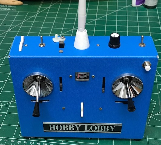

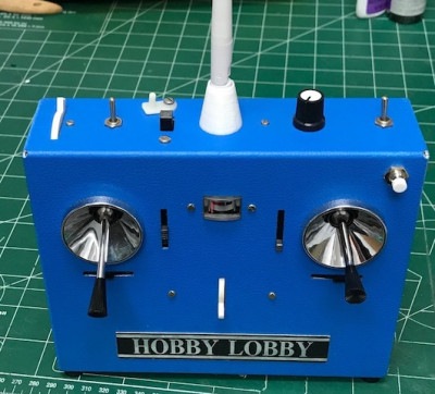

I often test fly one of my conversions as a slave on the buddy box. I did today. This Hobby Lobby (EK in disguise) hadn't flown in a while and I wanted to pass it around. People are generally nervous about flying others models but they usually step right up when they find out its just a slave to my holding the Master. I spent about 5 minutes setting it up at home to get the trims close. We definitely spent more time than that handing it around
I acquired a nice DIY Reed from Jean Marie (JMP on RCG). We have flown it stand alone and as a buddy box. Its a great way to let others try it.
Its a great feature that really works well. Put a Spektrum module in there and go for it Jay:) And once you get it trimmed and get the hang of it with a little confidence, cut the invisible cord and bind it directly to the airplane and go!
Scott

There is a very easy way to wirelessly "buddy box" any two transmitters together using an onboard servo multiplexer from Pololu:
https://www.pololu.com/product/2806
or Wireless Buddy Box from Hobby King:
https://hobbyking.com/en_us/wireless-bu ... oller.html
You need a receiver for both transmitters and both connect to the the "multiplexer" with the master having an additional channel to control the master/slave. I've used both the Pololu and HK and had hundreds of flights without an issue. It beats having to connect two transmitters with a cable and will work with any brand of transmitters, they can have different channel orders, it just doesn't matter as you put the channels in the correct order with the leads.
As I wasn't confident flying reeds in front of a crowd at the time, I took a wireless buddy box setup to Ponty in 2018 with my Graupner Variophon (slave) buddied to my Skyleader SLX (master) flying an old Junior 60. If any of my friends want a go at flying R/C on my farm, its what I use with a modern JR (slave) and Skyleader (master) with a Mini Super trainer or MPX Easy Glider.
