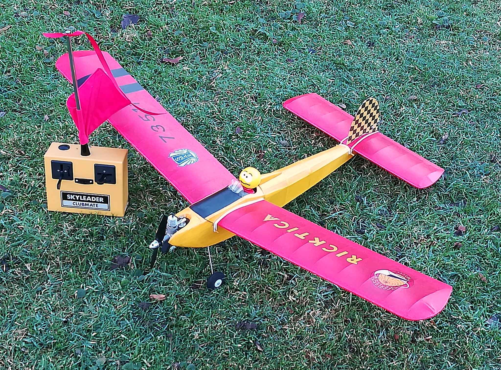

They've changed the rules for the spot-landing competition at Old Warden so whereas it used to be that for the May event the comp was for Mercury Magnas (only), now they have widened it to ANY kitted model. Wanting to build something a little "different", I went for the "Ricktica" which was kitted by Peerless Models in (I think) the early 80s......

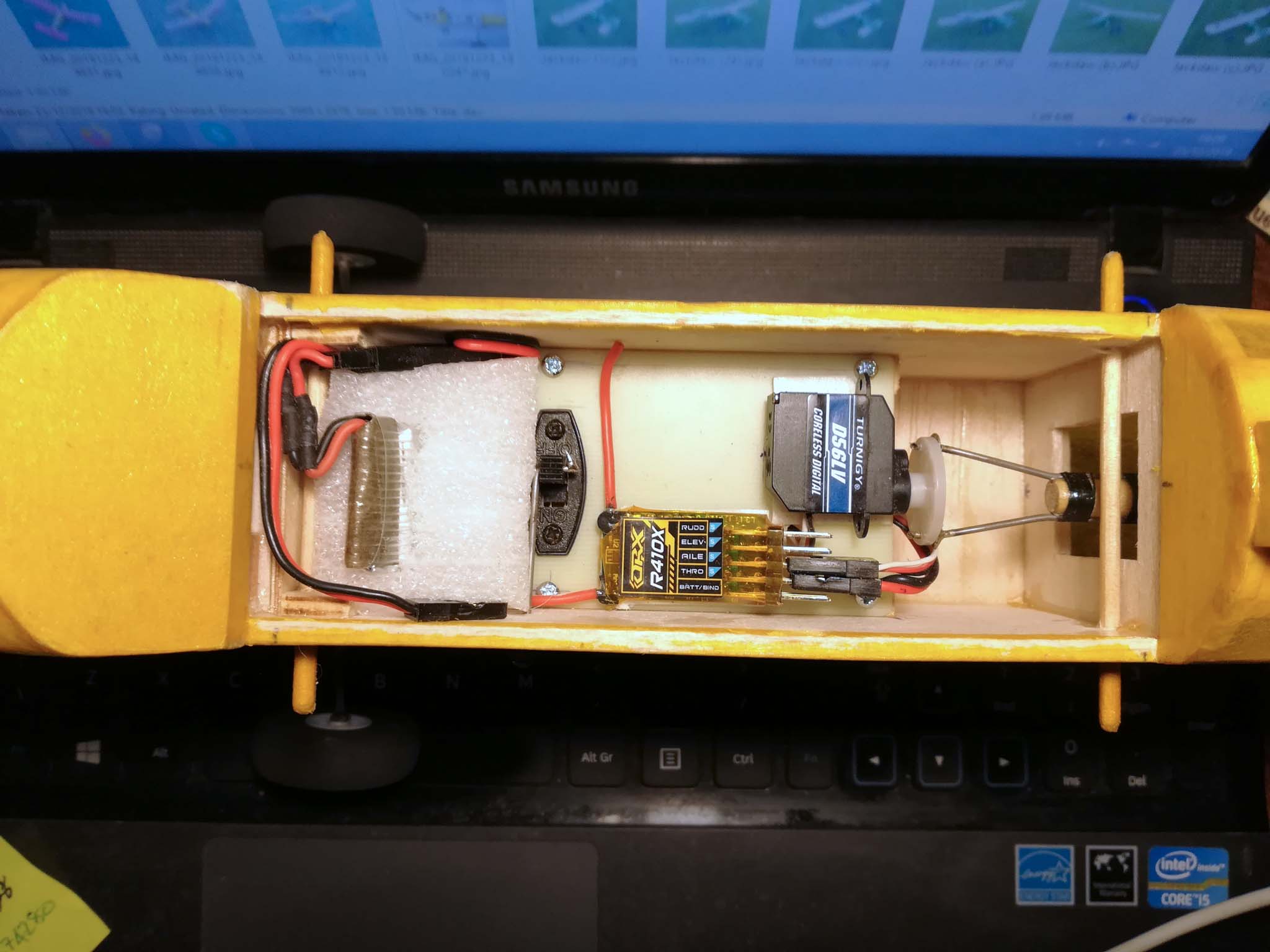

"Power" (if you can call it that) is a CS Mills .5cc and the radio (Rudder only) is my recently converted Skyleader Clubmate with Orange R410x receiver, a 1S lipo and a Turnigy D56LV servo in the model.

Just an observation. The Rx is only specified down to 3.7v. Have you used it before with a single lipo without issues?? The Micro 4 and the Lemon Rx are spec'ed down to a lower supply voltage and may prove more reliable on the single lipo http://www.micronradiocontrol.co.uk/rx_spektrum.html

Jackdaw, 'good thought but I've been using this setup for four years now and so far, I haven't had a problem. I mostly use 700mAh drone batteries which are small and light and way over the capacity I need. Fully charged they read about 4.1v - 4.2v. and still read around 4.0v at the end of a flying session. I have about half a dozen of the Orange receivers and few Spectrum AR400 receivers and so far none of them has let me down. And perhaps here would be a good point to put in a plug for the little Turnigy D56LV (Low voltage) servos. They are very small, have metal gears and are fast and powerful...... a great little servo and they too have given 100% reliability.

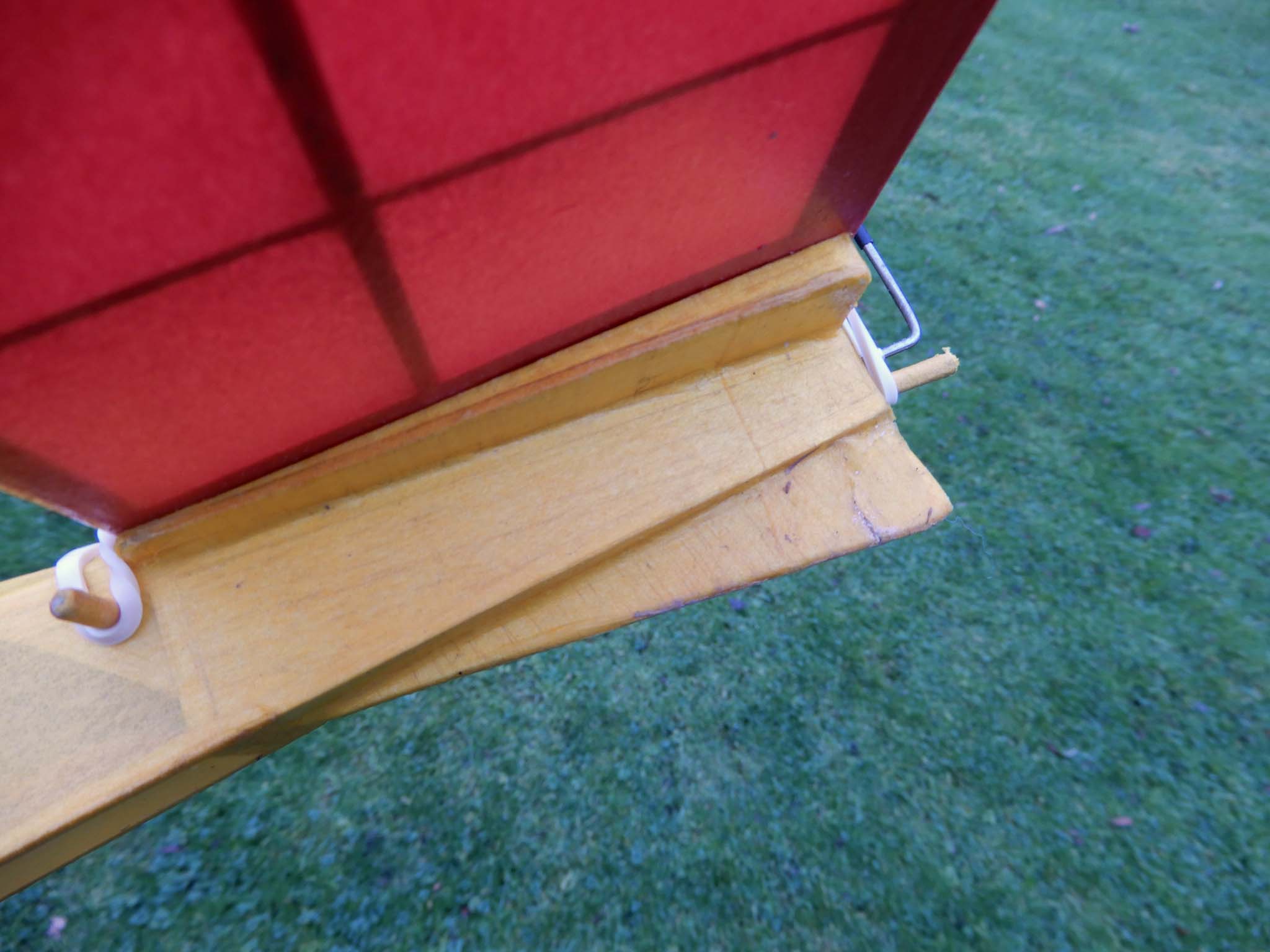

The mild weather of the last couple of days has allowed some test flights. I think it is fairly accurately built and the CG is in the right place but FWIW it needs 3/16" (5mm) of packing under the trailing edge of the tailplane.
In the calm conditions it was a delight to fly on rudder only and I achieved three landing on it wheels! However the little CS Mills is very marginal power and I felt I was "milking it" much of the time. If there was any wind I think it would need more power and I am thinking about changing the engine for either a DC Dart or a Redfin.030.Paul
