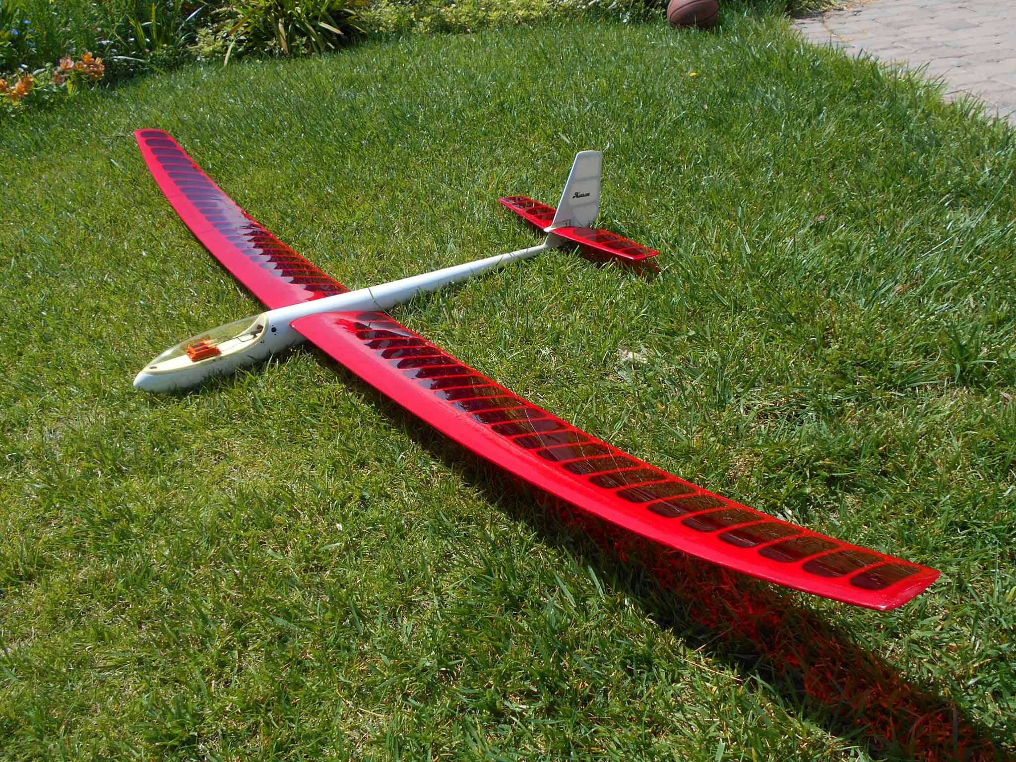

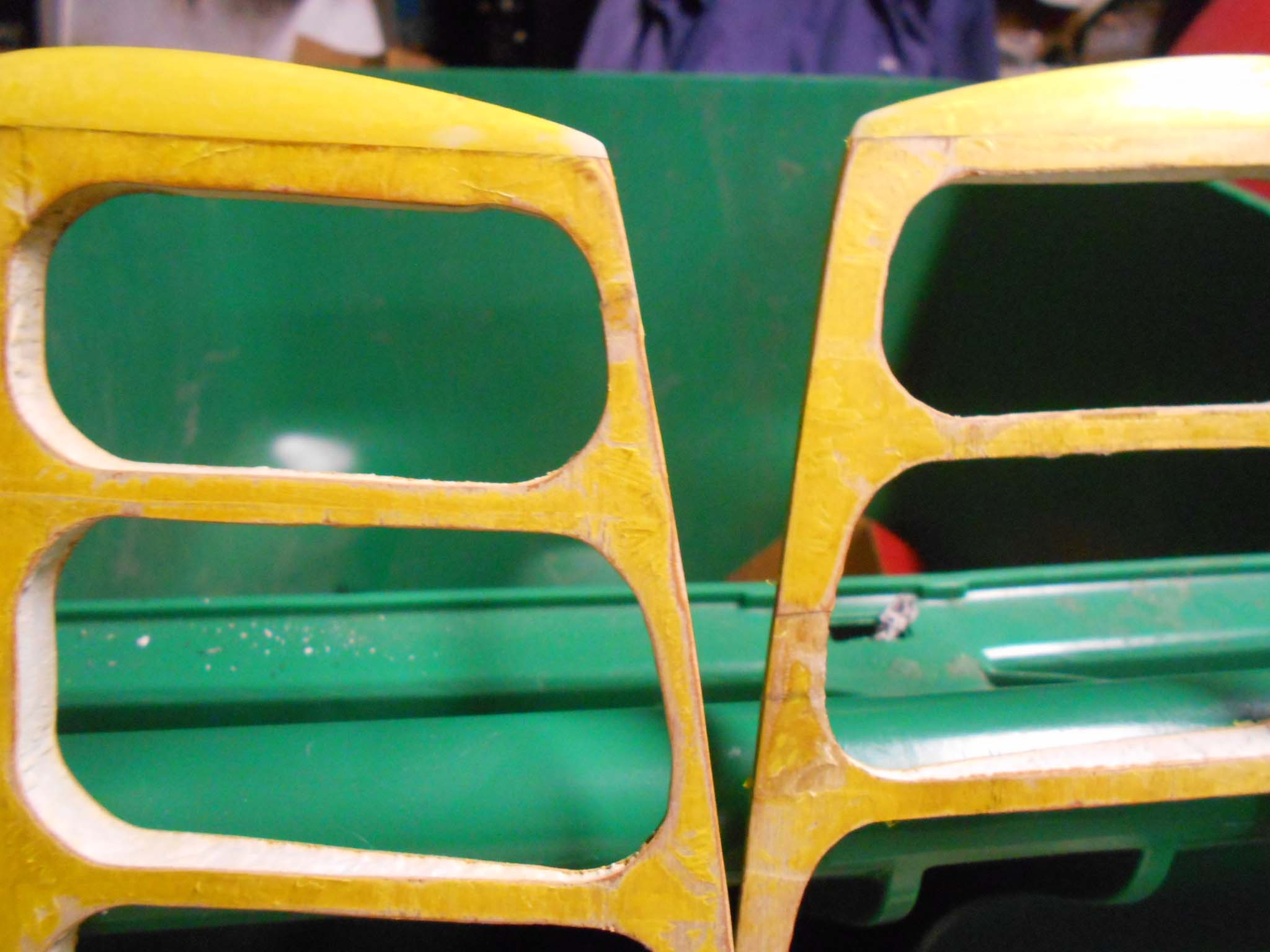

I have had this Hobie Hawk since the 1970s, it has flown up and down the west coast of California from San Francisco to Baja and has hundreds of hours of airtime, mostly slope soaring over coastal cliffs and the ocean below. The fuselage is on it's 3rd paint job, second set of wings and tail feathers, the servos finally wore out and were replaced, , 5th set of batteries, BUT, the Novak 6 meter 53 MHz receiver is still working perfectly.

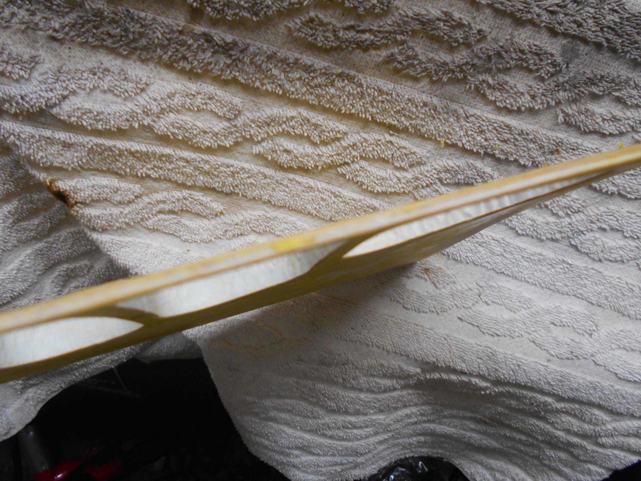

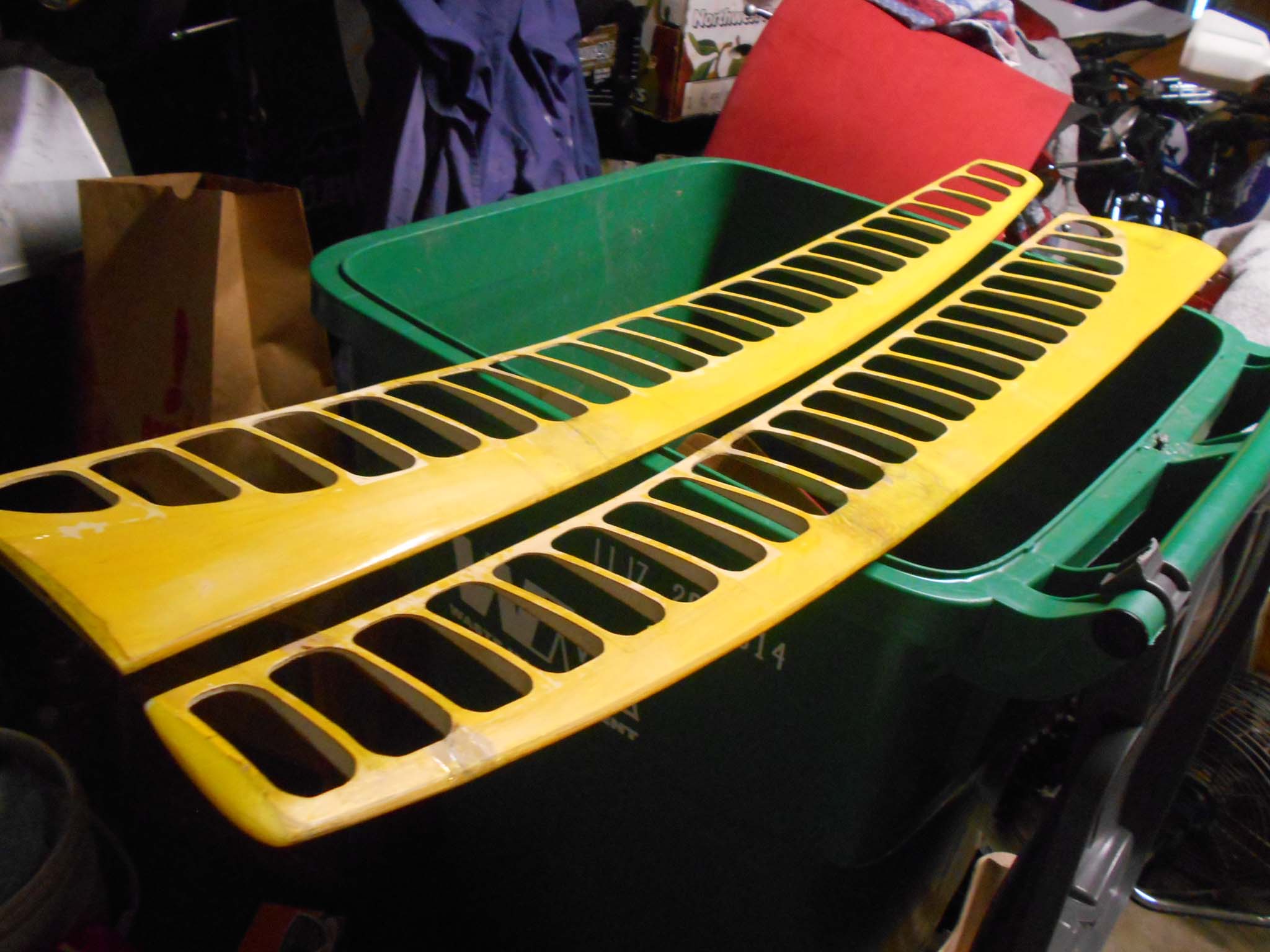

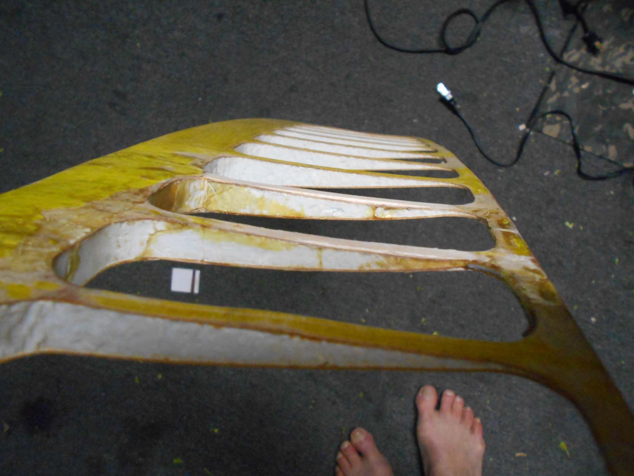

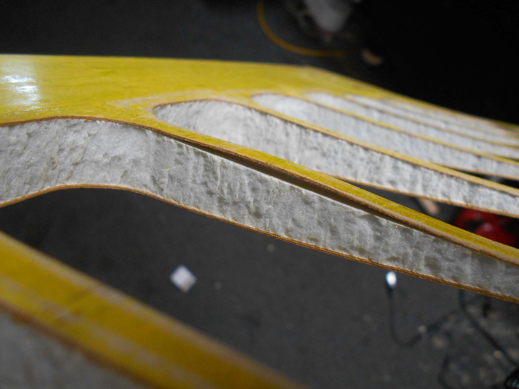

I'm stripping and repairing the wings, then will be re-covering them with transparent orange. The Hawk was originally all orange but in 1980, Ron sailed his SR-71 right through my starboard wing and turned it instantly into tinsle. Since then the Hobie has sported a replacement set of wings and stabs covered in t-yellow. But with this re-covering it will be back to all orange once again. It will be in top trim for Weaselfest at Ellwood and Katie Martin at Torrey pines, both of which are nice slope soaring meets here in California. You will note that I had to build up the ribs with balsa where the foam collapsed due to overheating with the Monokote iron. There were also some delaminated areas of the plywood skins.

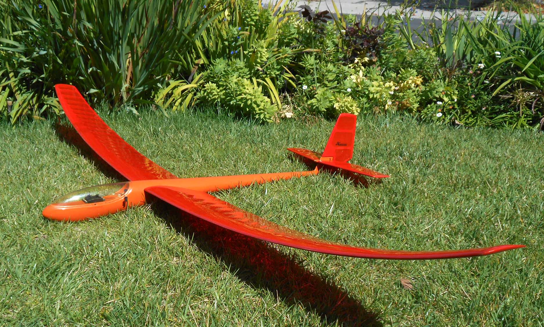

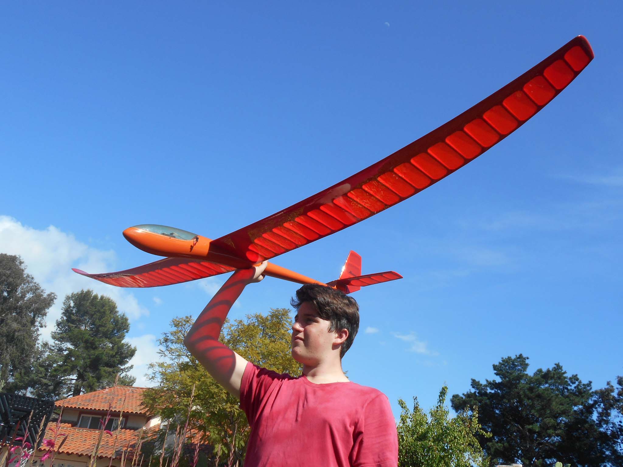

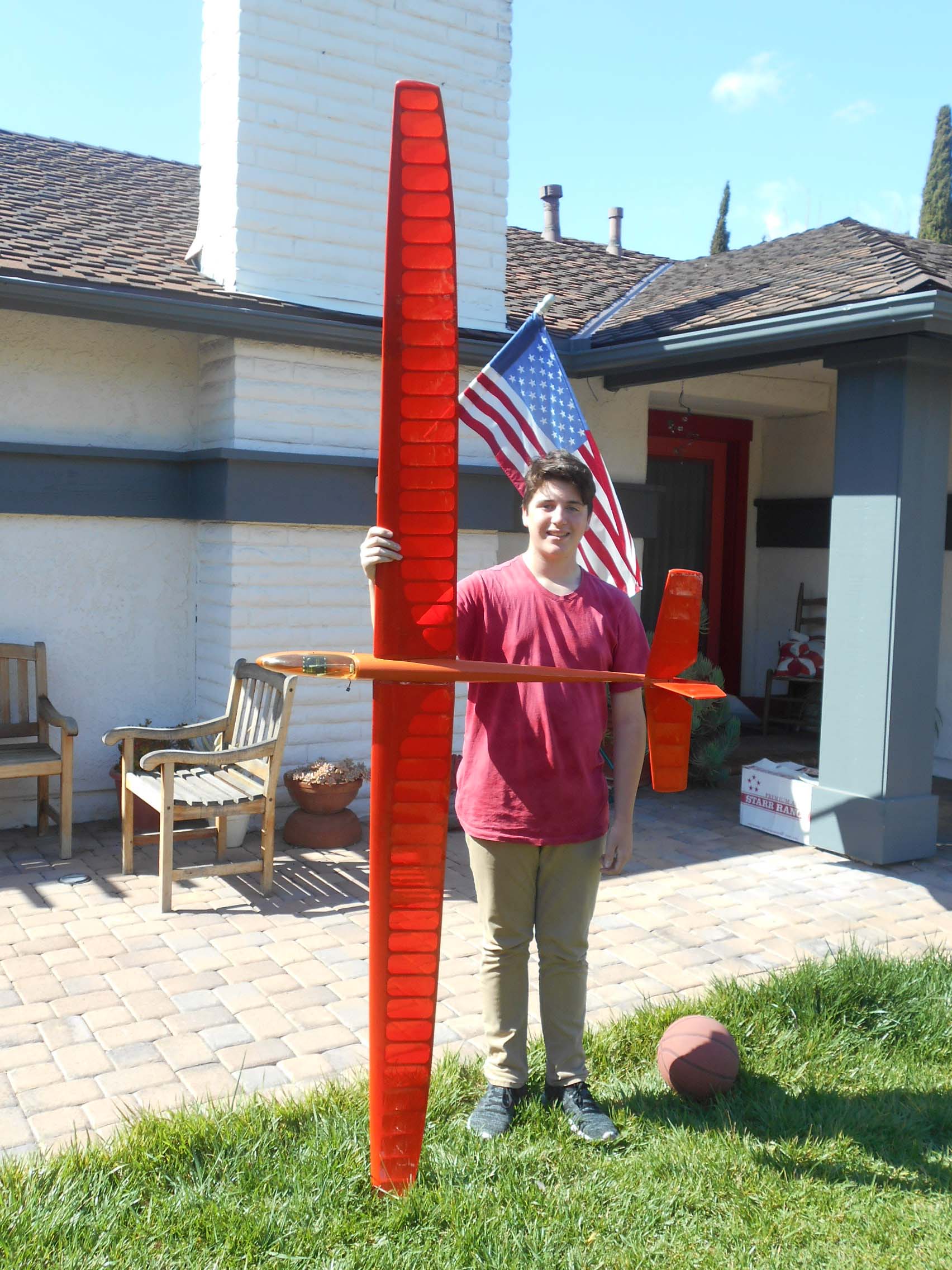

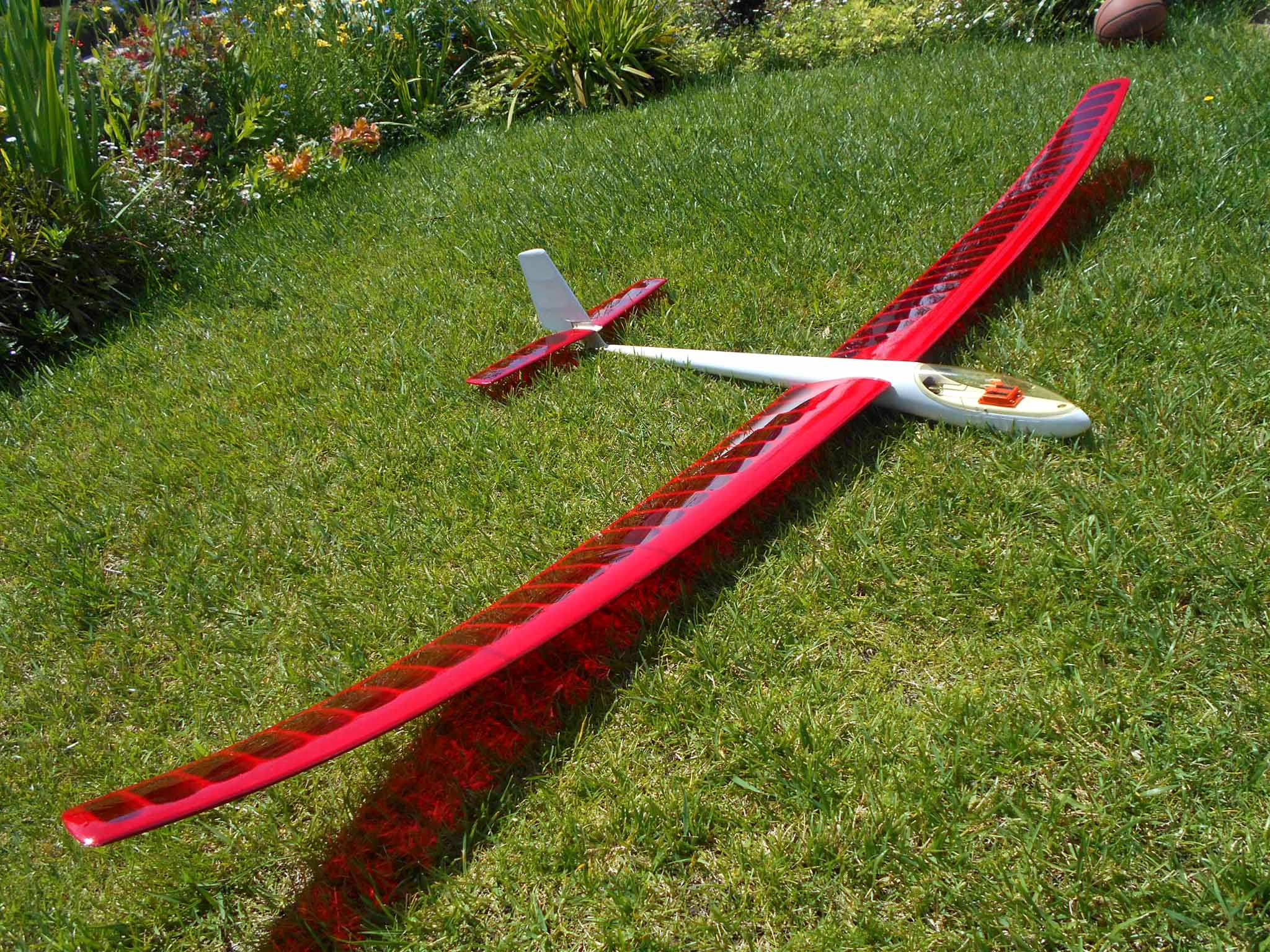

Well, the Hobie is now restored and recovered, ready for the slope!
My son Bud is holding the Hawk. attachment=1]Orange Hawk (4).JPG[/attachment]

It looks fantastic..... How did you re-attach the delaminated skin to the ribs and I imagine it was quite a "challenge" to cover the top surface of the wing....? Well worth the effort though, well done!
Re: Hobie Hawk restoration
It looks great - well done!!

The plywood skin was re-bonded with 5 minute epoxy, I applied it with an exacto #11 blade.

I take and clamp the wings to a 4 foot long 2x4 piece of spruce to flatten the wing and cover the top first. The bottom of the wing is covered after removing the wing from the board. Alternatively, large tomes, or phone books can be placed on the wing to flatten it on a table for covering the top.

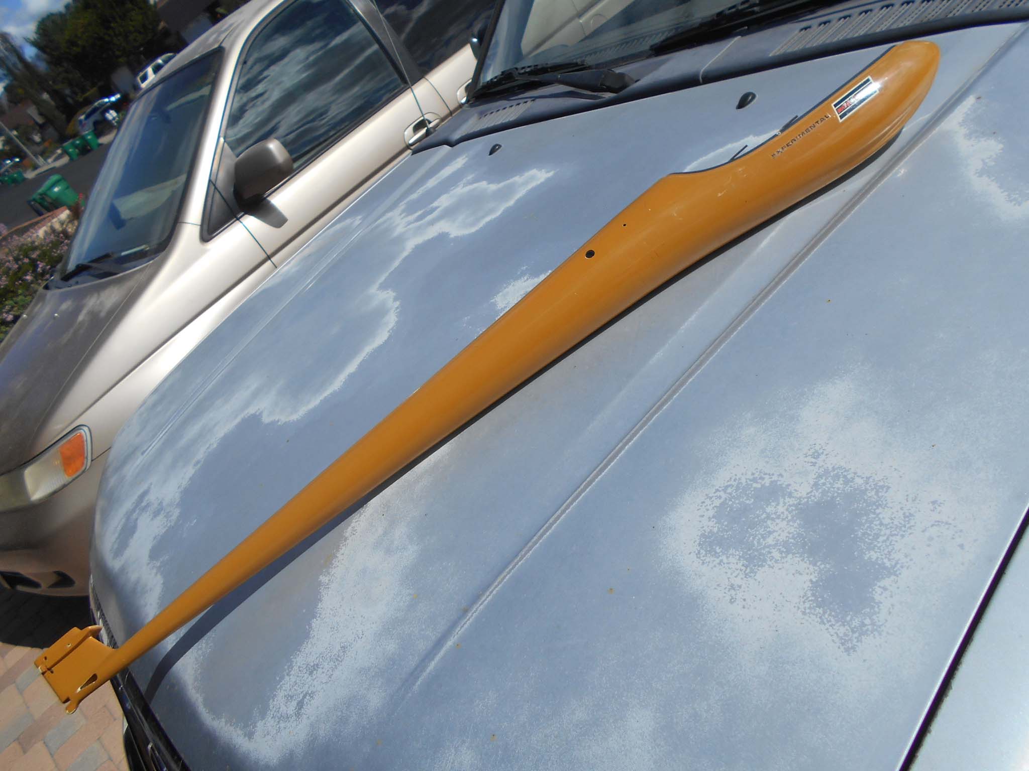

This Hawk fuselage belonged to Rich Carillo, he was the production manager at the Hobie Hawk factory. He gave it to me for repairing his Hawk. Some of you may recall Carillo racing rods, used in top fuel dragsters, that was his dad's company. My 1st Hobie was a T-red and white ARF version I purchased new in 1975 while in the USARMY, but I sold it when I was transferred to Ft. Huachuca, so this is now my replacement.

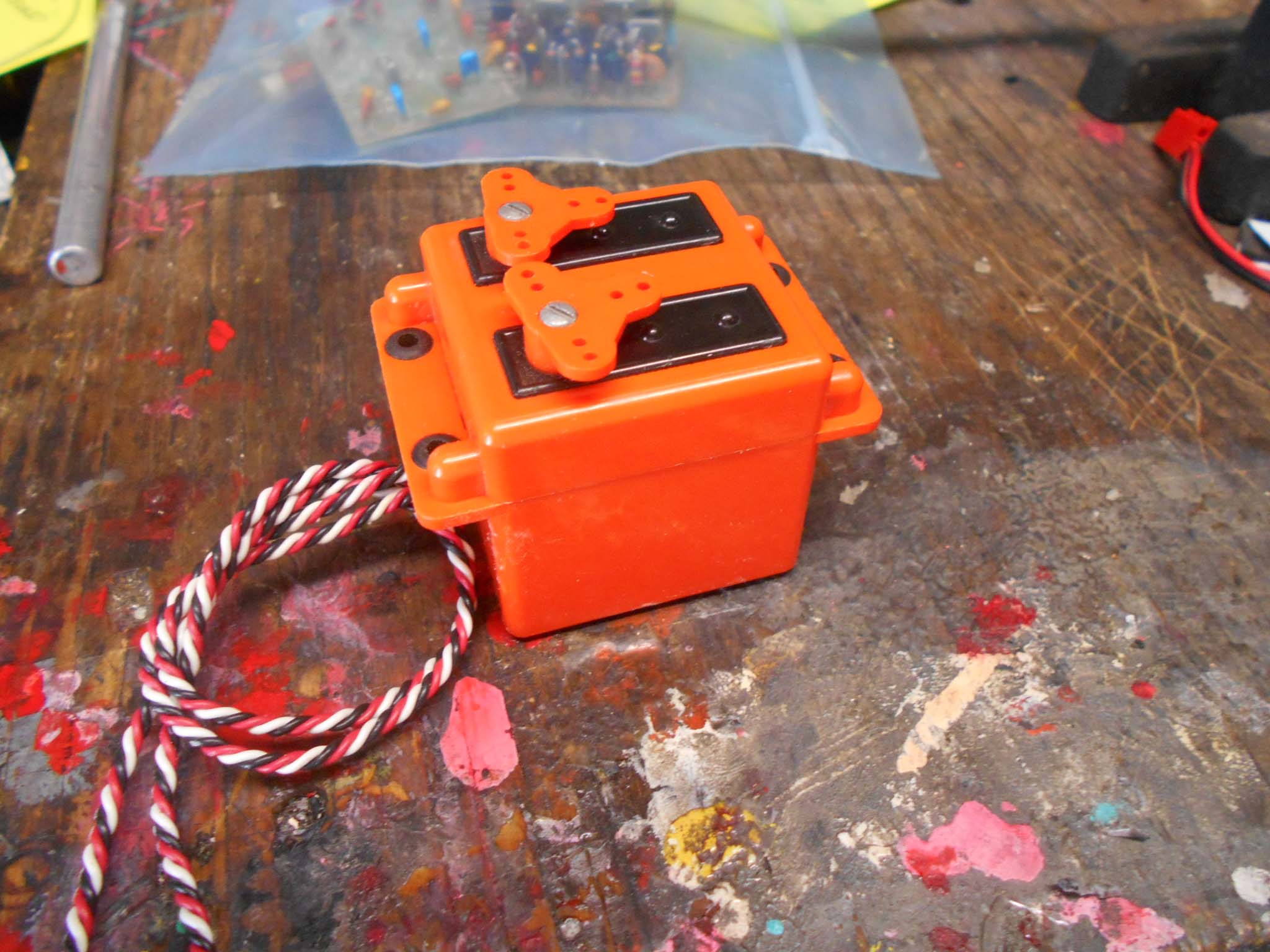

RS Systems made a special 2 channel radio system with this cute 2 servo brick especially for the RTF Hobie Hawk
