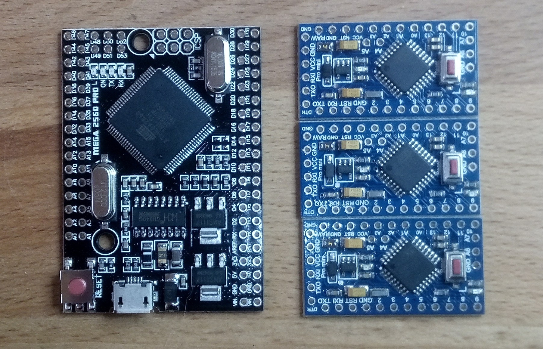

Edit: the 2560 has arrived, its a bit bigger than I expected (about three prominis) , but when you're holding 16 analogues and fifty-odd digitals in your fingers its most impressive. Tried a few things and it does everything you ask!
A bonus is that the bootloader delay is negligable, maybe 200ms so its quick enough for me and I'll probably favour USB programming after all!
