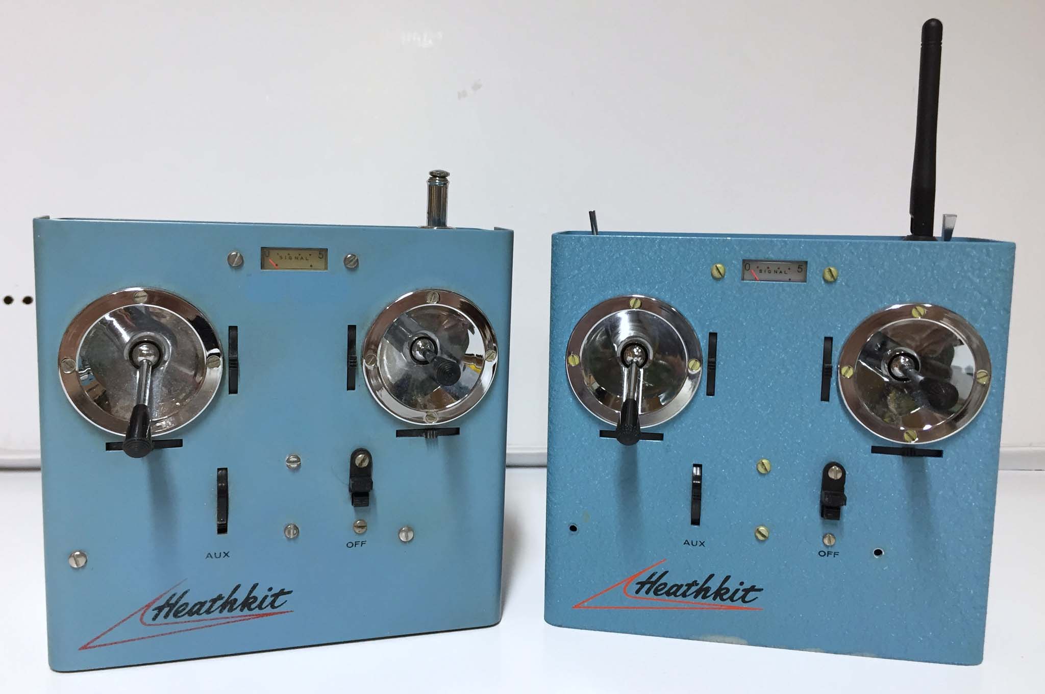

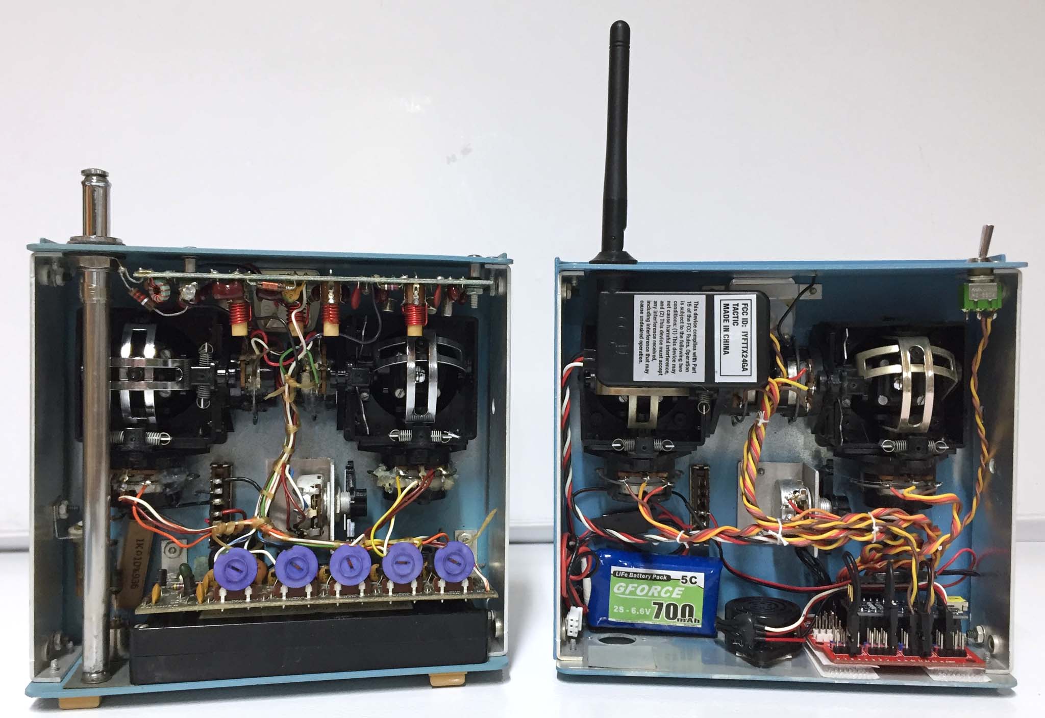

The conversion to Arduino of the first Heathkit GD-19 is a success! I just got done completing a short test flight of an electric PBF foamie in my yard, and it worked perfectly. The one on the left is a future conversion project, and the one on the right is my first conversion. The encoder is a Nano on a modified redboard shield. The RF section is an original Anylink. The software is Phil Green's 7 Channel Encoder sketch, with some modifications for dual aileron servos, flapperons, 100:100 elevons, and some other things. The stick pot wiring was scavenged from some dead 9 gram servos, which worked great to plug into the redboard. Extra spektrum bind plugs are used to enable/disable the elevon mixers, the calibration mode, and the channels 5 and 7 swap. The redboard, buzzer, and battery are held in place with velcro for now.......maybe permanently. The switch on the top right is the throttle safety/cutoff, and the one on the left is the flapperon enable/disable. I didn't install a channel 7 switch yet, since I doubt this transmitter will ever be used to fly something that needs 7 channels.
I haven't figured out how to make the original meter work with the 2S life battery yet. I've seen some photos of others with a digital display, which would be even better. Still need to do some more researching.
Thank you Phil for making the 7 channel encoder sketch available to everyone!
