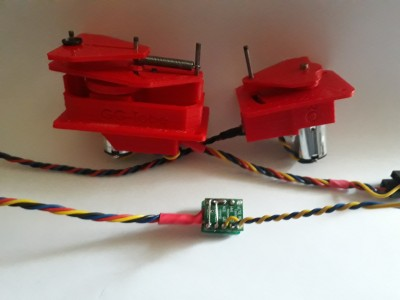

"I would like to introduce to You were we are today about the Tobe actuators for Galloping Ghost and its availability. As mentioned in several occasions the actuators are built around Phil G's impressive work creating a proper Recoder that allows to connect the actuators directly to a modern receiver. My actuators have evolved from the first prototypes to a PnP set up which make them almost as easy to install as any modern servo. You are able to see in the included pictures how the Recoder have shrank over time and is now down to just the size of the components and fits directly on the actuator.
For the time being I'm trying to keep both the Adams clone and the GG-Tobe in stock and the actuators can be shipped as PnP or just bare. The PnP actuators have a built in Phil G's recoder and are designed to run on 5-6 volt that allows them to directly to plug in to almost any modern receiver.
Both actuators are not really suitable for a direct replacement in old equipment as the original ones were running on 2,4 -3,6 volt.
Of course You can still get the bare actuators from me if You already have a decoder from Phil, are planning to order them from him or have any other idea in mind.
The price for the PnP set are: $ 65 S&H included for the GG-Tobe and $ 45 S&H included for the Adam Clone. The bare actuators are minus $ 20.
The rudder and elevator plates for the GG-Tobe are directly compatible with those in the old Rand's and are available as well if You need spares.
The "loose " recoder is only included in the picture to show the new size as it's already included/built in in the PnP actuators.

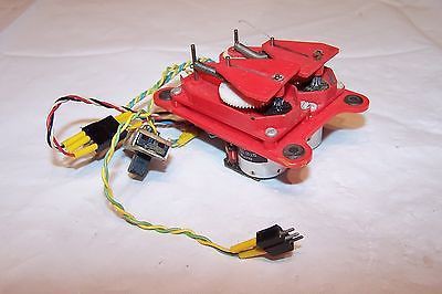

Tobe, in the notes for the original Rand it makes the point that the unit should be mounted on rubber mounts to avoid vibration. The model I have built for your actuator will be powered by a PAW 1.49 diesel and there is no provision for rubber grommets on the actuator itself so how important is vibration prevention with your "modern" unit?
- Posts: 712
Re: GG-Tobe
Vibration are always a concern particularly if you fly IC/Diesel. You will have to mount the actuator to a regular plate which then is equipped with grommets like it was done on the original Rand. I don't have made any specific plates as one in 1/16 plywood is probably the easiest one.

- Posts: 1232
Re: GG-Tobe
I just used a couple of thicknesses of double sided servo tape under the Tobe Rand, than used screws only just tightened to slightly compress the tape on to the mounting plate...
Other option is you can buy small soft o-rings from Hobbyking used for mounting multi rotor flight controllers on..
- Posts: 652
Re: GG-Tobe
Thanks both. 'Not a big deal but I fear a slight rethink is needed....... I think I had hoped that modern electronics were immune to problems of the past like vibration! The model isn't quite finished yet but I thought I had finished the installation. I had mounted the Rand on a 1/8" ply plate which in turn was screwed to rails on the fuselage sides. I have now ordered some 1/16" epoxy/glass sheet and rubber grommets and will remake the plate.
