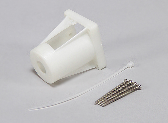

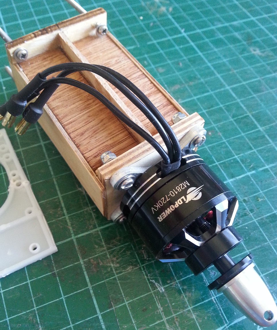

the original plastic motor mount (pic off the HK website), which doesn't fit the motor I have, so a new mount is needed. Its also a bit light for my liking.

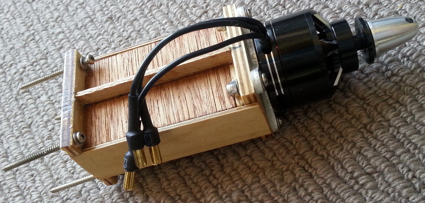

this is the new timber motor mount I have constructed.
slightly longer, much stronger & reproduces the 3 deg. down thrust of the original.

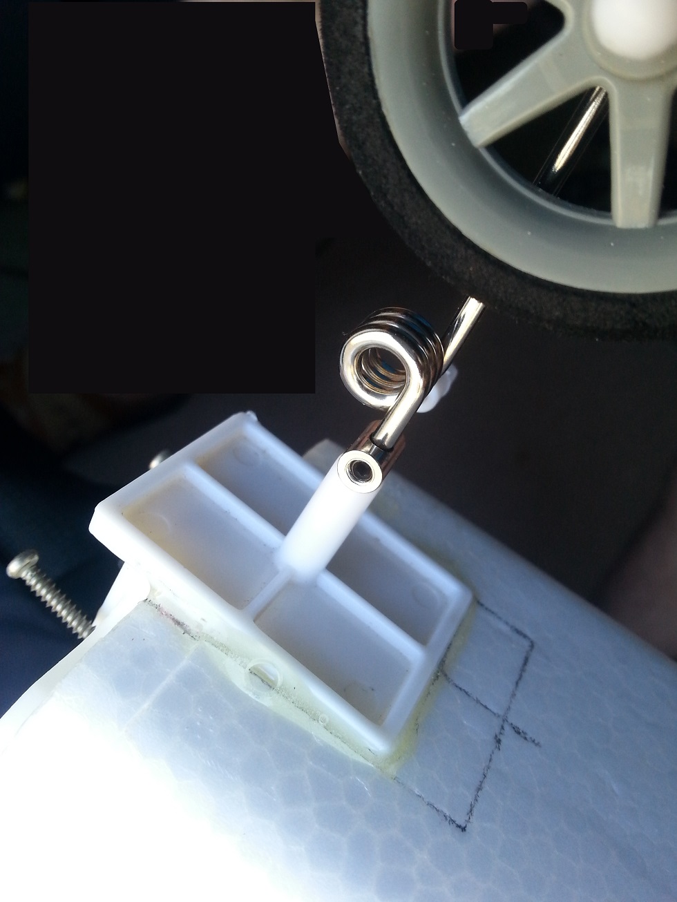

Another $1 bargain bin purchase, the nose wheel assembly from the HK Mule - utilised since the fuselage didn't come with any undercarriage components.

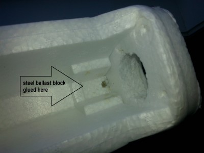

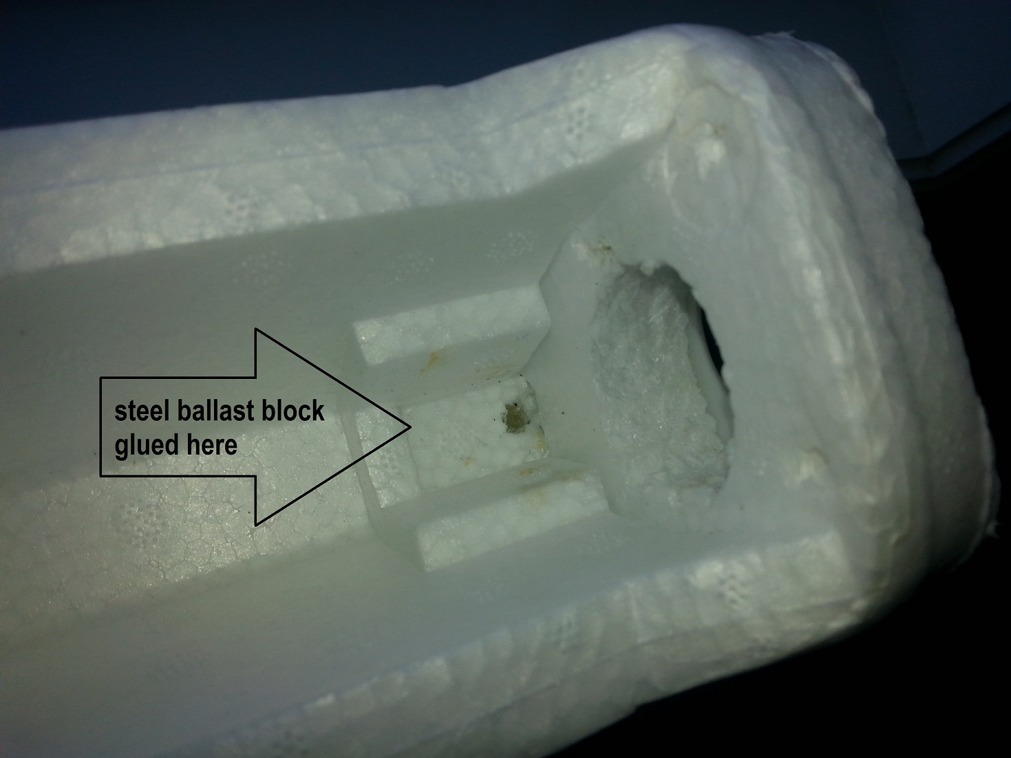

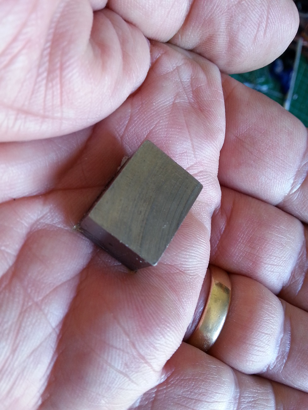

I was surprised to discover a lump of steel embedded in the fuse behind the firewall - obviously to correct an inherent tail heavy condition with the original design. Since I was using a larger (& stronger) motor, I removed the steel slug:
the slug of steel removed from the nose.

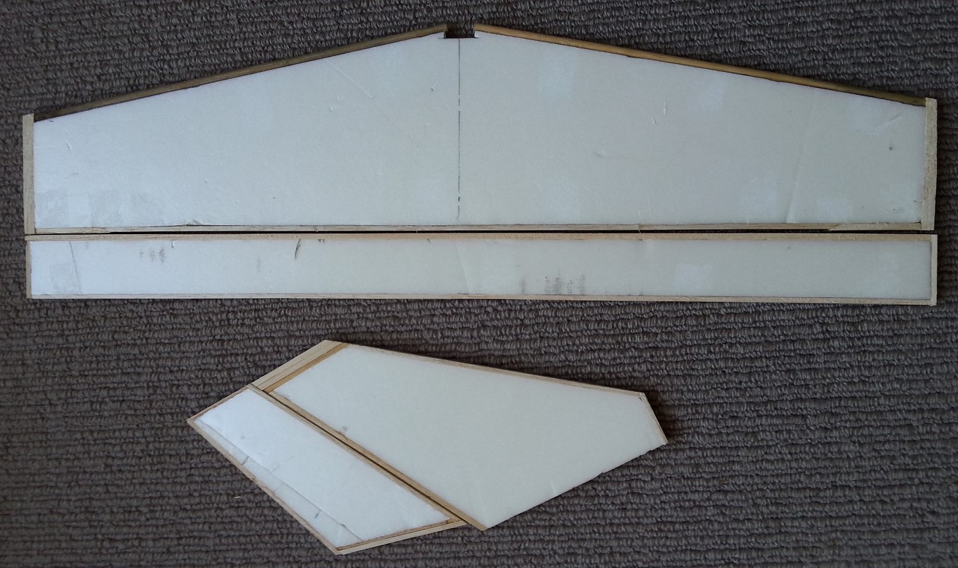

I've made up new tail feathers approximating the outline of the original, based on pictures on the HK website. After sanding, they'll be covered & decorated with plastic film and/or coloured trim tape.
The tailplane & fin are both made of 5mm foam sheet with balsa edging. The Tailplane LE is 5mm bamboo.

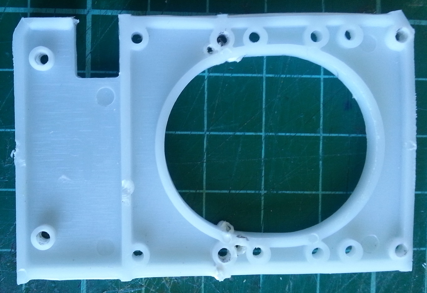

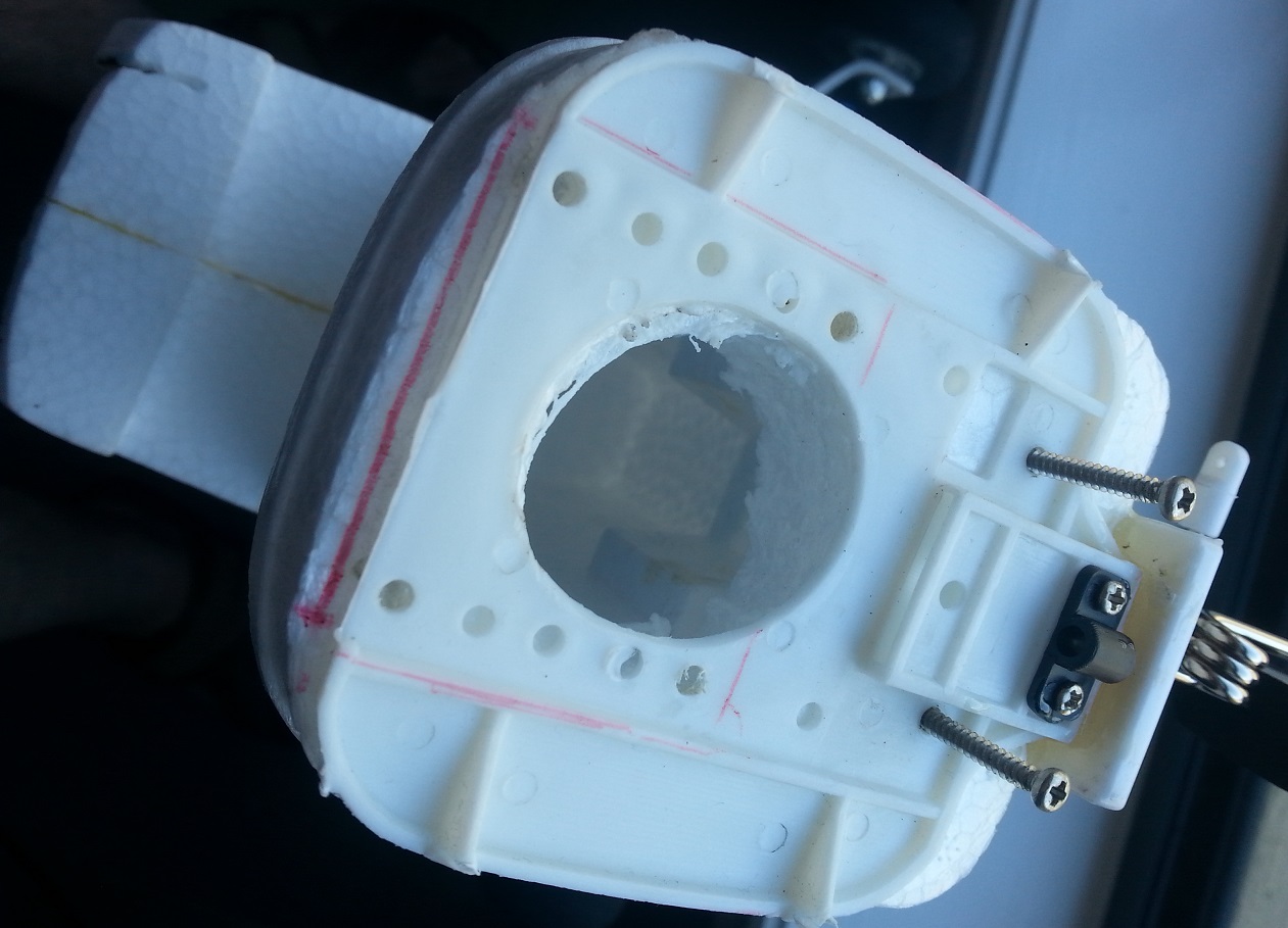

The original design utilised a plastic motor mount with down thrust moulded into it, sitting against a plastic firewall with side thrust moulded into that, which then sandwiches the foam fuse between another plastic fitting as an anchor plate, the whole lot is then clamped together with 6 long screws.
firewall with side thrust. Original nose wheel mount is at the bottom.

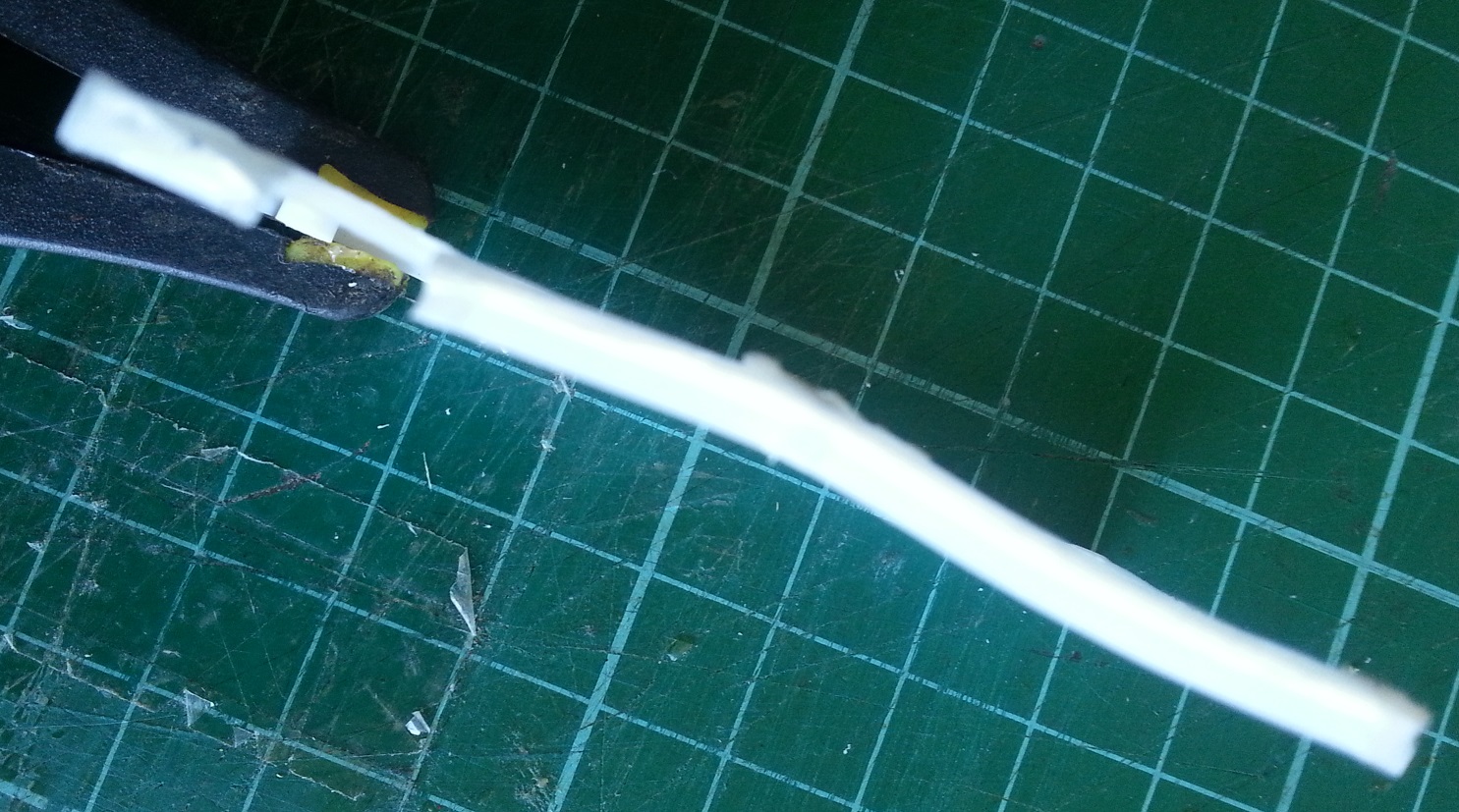

Unfortunately, this setup is subject to deformation, particularly of the anchor plate. I'm also suspicious of its ability to withstand a heavy landing.
you can see how the anchor plate has deformed when the screws were tightened.
I intend to replace all the plastic bits with a stronger purpose designed timber arrangement that will distribute the load to the fuse sides as well as the nose.

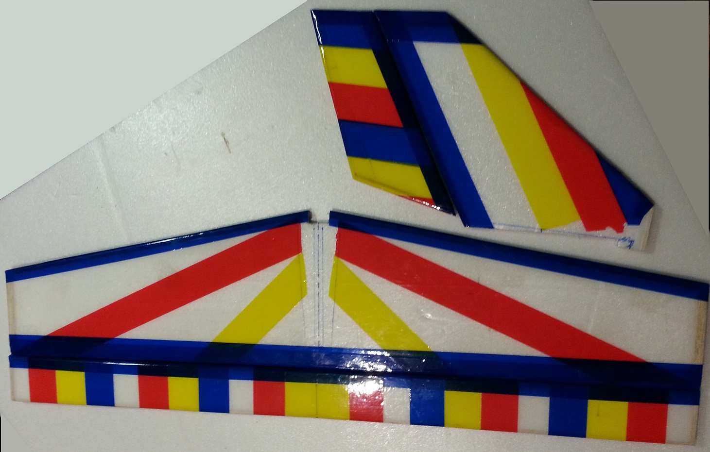

A little more progress - Tail feathers sanded & finished with coloured & clear tape.
Fin & top of tail-plane. The unfinished bits at the base of the fin are hidden by the ABS upper fuselage moulding.

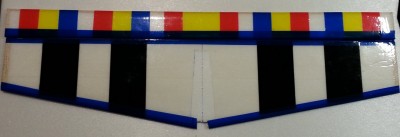

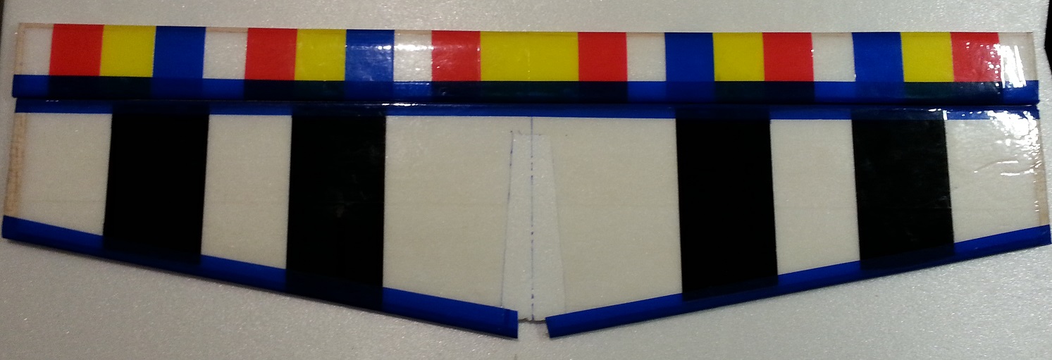

Alternate high contrast scheme on the underside of tail-plane. I've used this scheme for years on my F5B gliders & it works a treat! The underside of the wing will have similar.

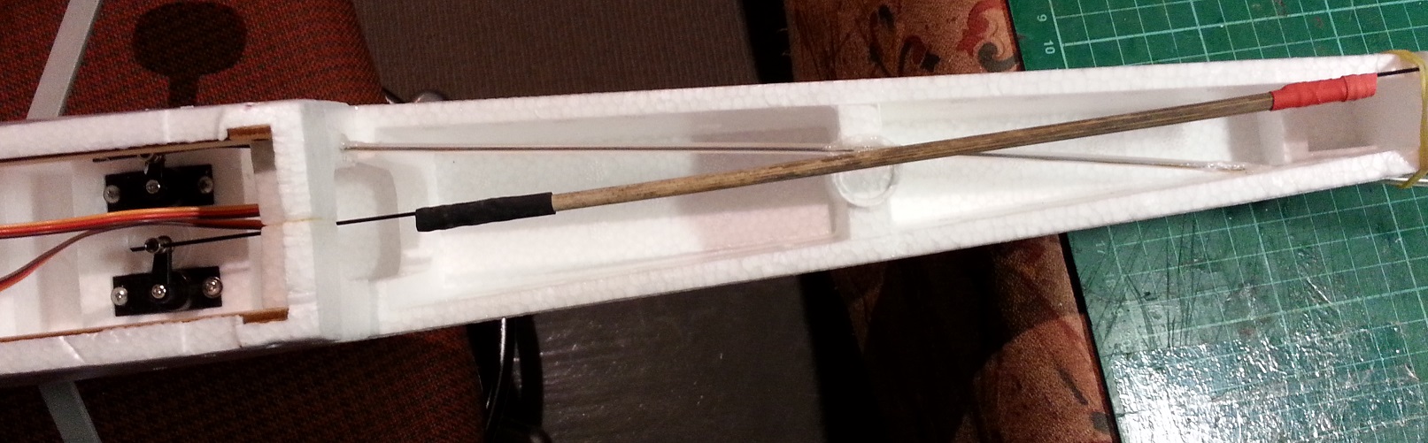

Rudder & elevator servos. Wire push-rod (as per original HK detail) for elevator & bamboo push-rod for rudder

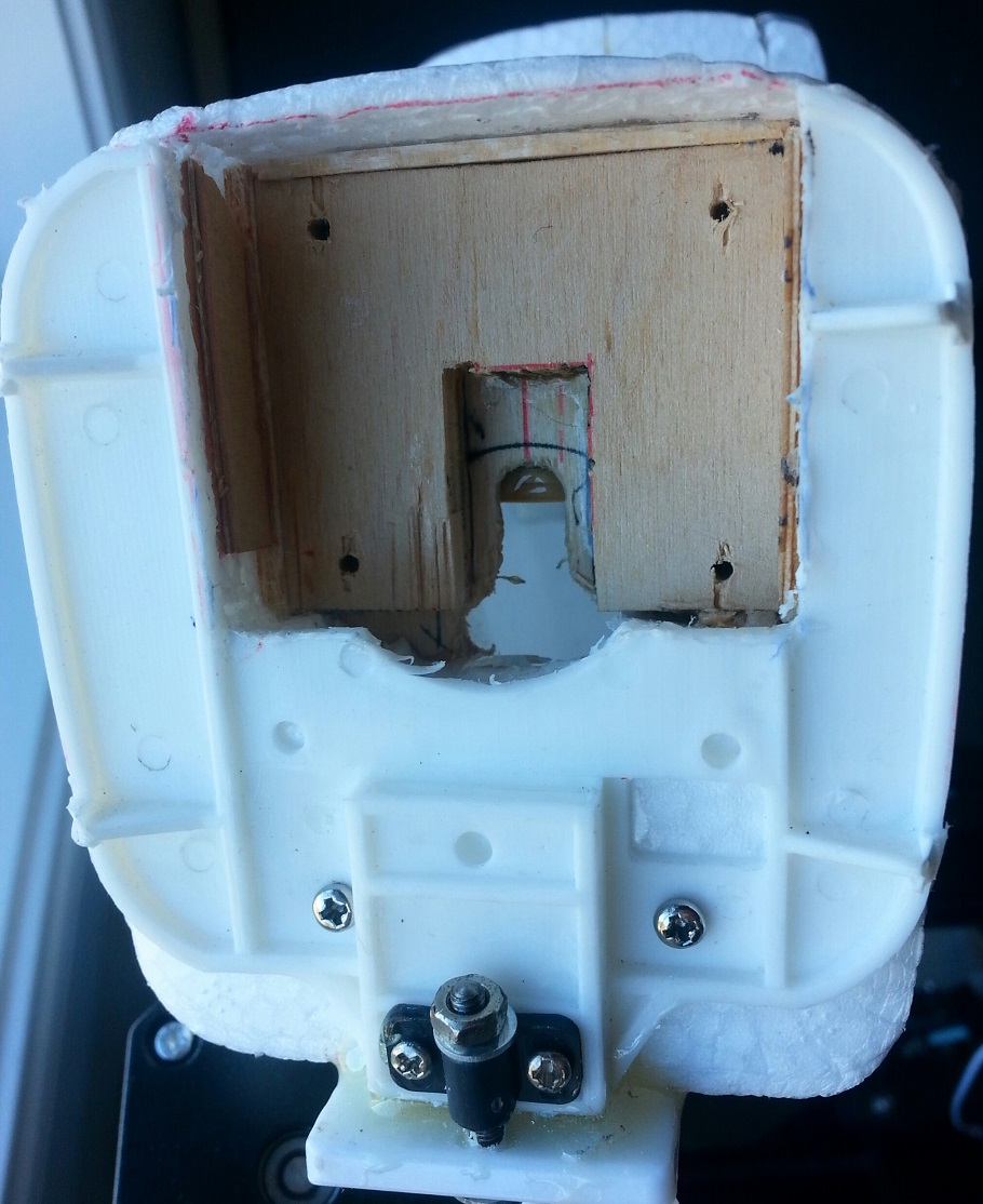

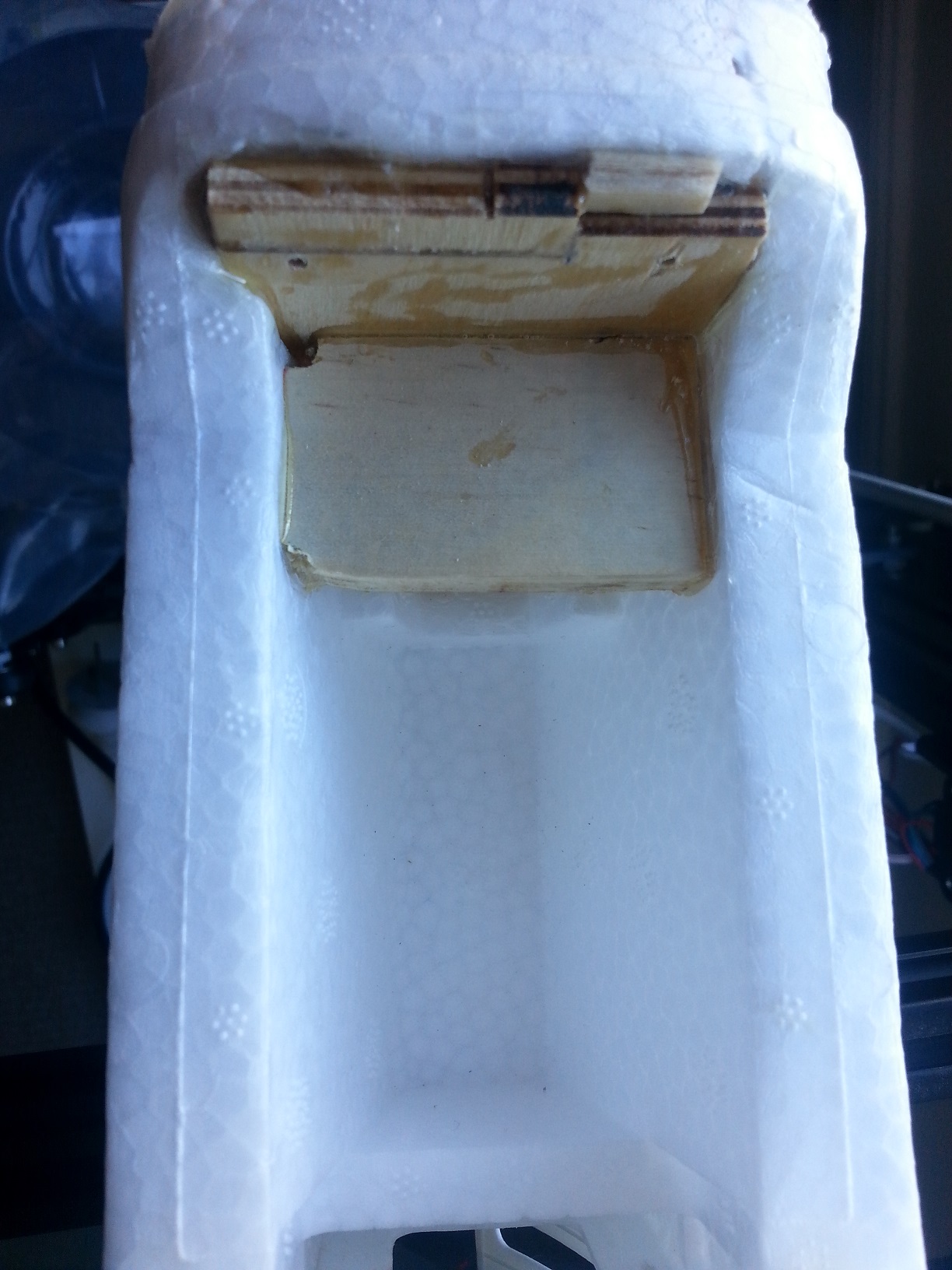

+ plastic undercarriage mount replaced with ply version
+ new timber firewall made up & epoxied in including locating spacers for the timber motor mount, & internal ply reinforcement added for cowl mounting screws. Looks a bit 'agricultural' (using left-overs from the ply scrap box) but it all fits together very nicely 8-)
old plastic firewall and foam removed & replaced with a new ply firewall
+ additional ply reinforcement added behind the firewall (over where the steel slug nose ballast was mounted) to distribute the load
additional reinforcement added to rear of the new ply firewall

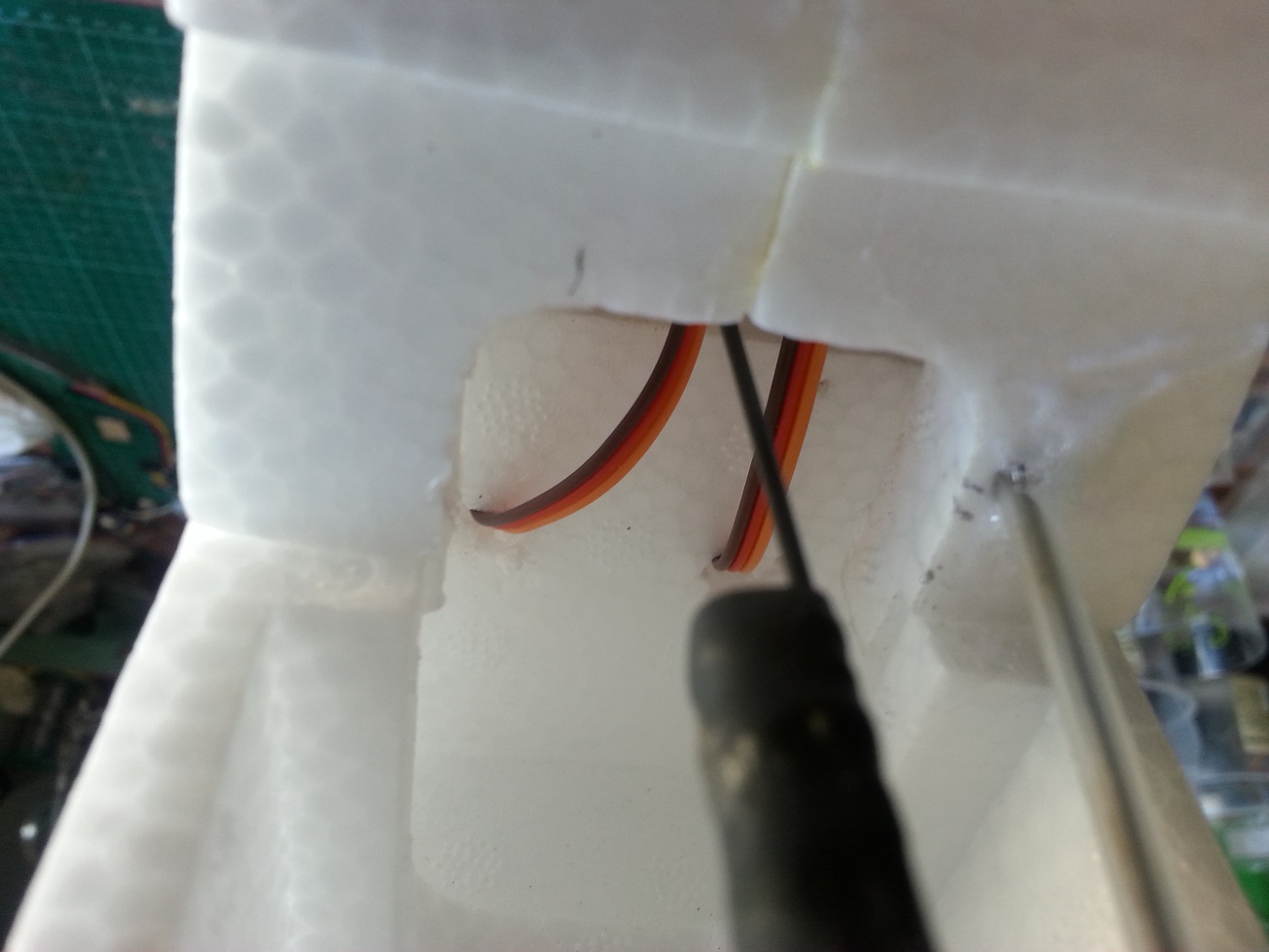

+ radio install cleaned up
there weren't any holes for the servo leads, so I punched a few in!
