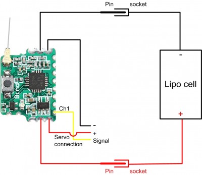

....hmmmmm....something's not right....followed Phil's diagram exactly......worked first time! ....I'll probably drop it.....
Just thinking, If I plug the battery into the rx with the wrong polarity will I get smoke?

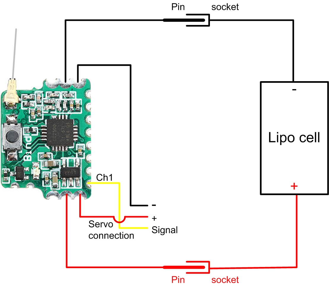

Heres a nicer picture:
Oh yes, from the receiver AND the servo!GarydNB wrote: 28 Feb 2019, 10:33 If I plug the battery into the rx with the wrong polarity will I get smoke?

I prefer to have a female connector on one battery lead and male on the other. That way you can't connect the battery up to the other gubbins the wrong way round. Of course you might then accidentally plug the battery into itself creating a dead short - but that usually only destroys the battery and not any other electronics!
I now chant the mantra, 'Red to red and black to black' when connecting batteries in an effort to reduce the number of batteries I destroy. Luckily the few I've destroyed have just burned through the tags that join the individual cells together (which act like a sort of fuse) - the batteries have then been beyond repair but at least they've not ignited, destroying a model or transmitter or whatever in the process!
