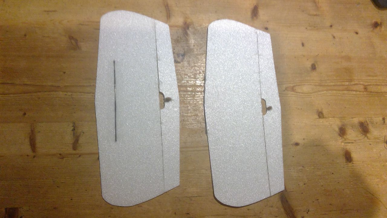

This the tailplane
Two versions
Lightweight with thin c/f on leading edge to stop rubber band cutting in
Beefed up version has a c/f spar which hugely improves rigidity
This the tail end - c/f pushrods - fin has a short section of c/f that goes up about third of the fin and down through the top and bottom of the fuz
I should add that the laser cut missed off the front l/e of the fin - hence a slightly less attractive shape!

I forgot to say on the pictures of the 3 x fuz that of the two that weigh 60g one has no servos and a cf strip the length of the underside - I set it up as a pitcheron experiment
